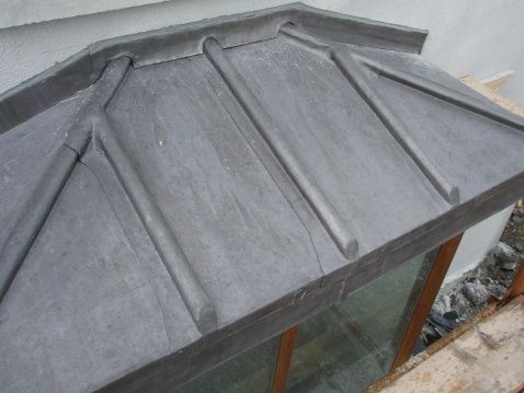

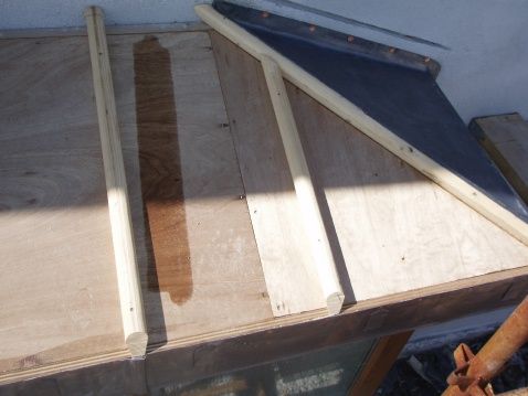

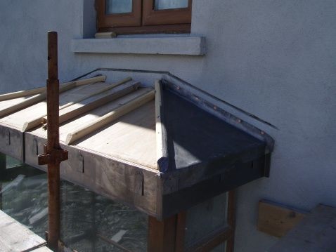

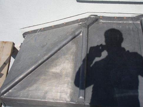

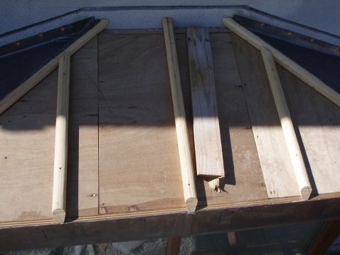

We first framed them & covered them with plywood then put on the wood core roll and then covered it with sheet lead. We also used lead for the facia….
Lead sheed one side of hip………….

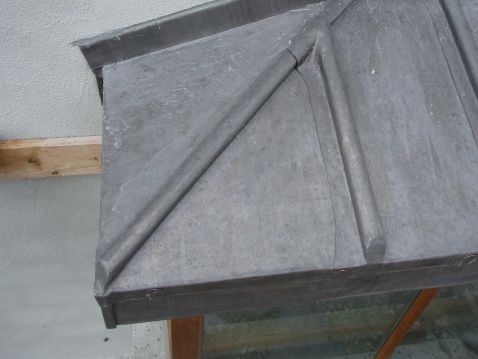

other hip…………….

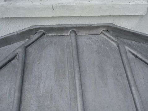

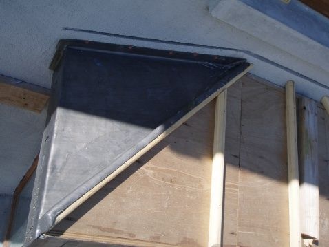

You can see the lead facia in this photo with 2 inch strips welded on, these strips fold back over the lead sheet that comes down over it………………..

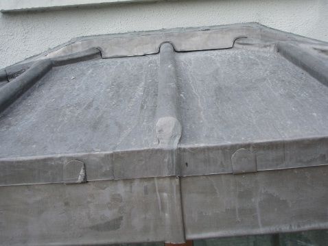

Overview of lead sheet at hip………………
Completed lead bay roof…………………
You can see the strips folded back up in this photo……………..

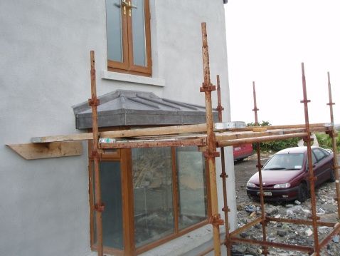

The house was built right on the end of a cliff over the sea, you can see a pier below with a fishing boat………… could have done with a handrail around the scaffolding!!!..

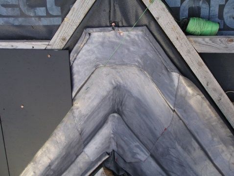

This is a photo of a valley beiing slated from a different job…………
This is at the top of the valley, one side is already slated……………………
