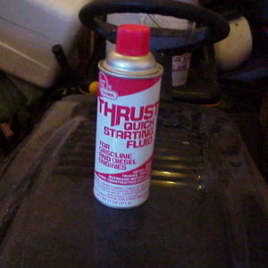

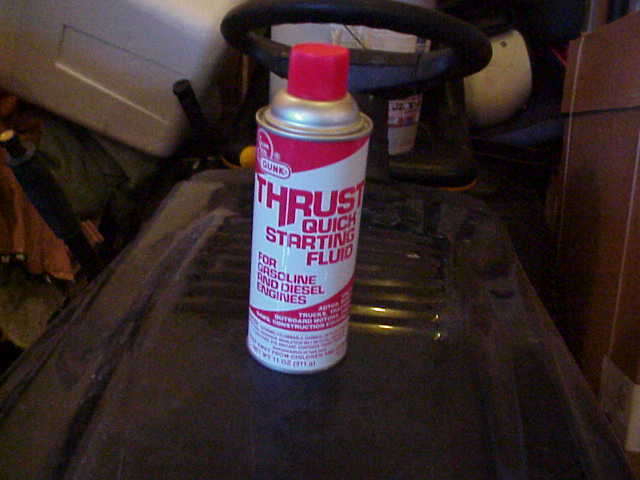

    Pull the plug, give it a shot of starting fluid (ether). If that don't work ,then you got a real problem!
    1. emaxxman | Jul 04, 2005 06:37am | #8
      How do I give it a shot of starting fluid? Do I put a few drops into the plug receptacle? Or do I dip the plug into the fluid?Is this fluid something I can buy at Home Depot or Sears...or do I need to go to a special hardware store for it?
      1. rez | Jul 04, 2005 06:55am | #9
        Auto parts store or wallyworld.
        Starting fluid.
        It's an aerosol spray can with the plastic straw like a wd40 can has.
        One short blast into the sparkplug hole. Insert and tighten plug without waiting around and then start it.
