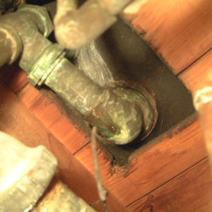

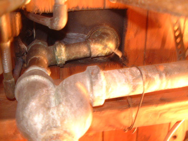

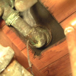

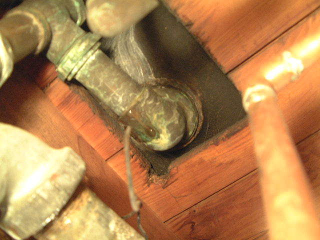

Attached are photos I took yesterday of the underside of the drain which is visible and somewhat accessible in the boiler room. The word ‘somewhat’ is relative – you can see some of the clutter in this area from the supply lines and the galvanized trap and waste pipe leading away.
My questions are this: Where should I start to try to stop the dripping? Tightening the pipe leading into the drain? (Why would it have gotten loose?) Or, removing it, wrapping it with teflon tape and reinserting it into a cleaned threaded drain?
Can I tighten the drain itself from inside the tub? Is this a kind that screws into something to hold it in place with one piece in the tub screwed onto the main portion under the tub? If so, what tool would I use – I’d hate to break the cross bar into which the drain cover/filter is screwed. Is there supposed to be some type of washer or seal in between these parts? Does that wear out and fail? Or are these standard items than can be purchased new and installed in place of this older one?
The BIG problem is that the water drips right onto the oil burner. Not onto the furnace, but onto the actual oil burner head with all it’s electronic gizmos exposed and attached. Don’t want a shorted out furnace if you know what I mean.
Sorry, forgot to take a photo of the top of the drain inside the tub. Two of the photos appear to be the same, but I adjusted the settings on the camera in hopes some additional detail would stand out for someone to notice something (besides the fact that I need to take photo taking lessons).

    Can you tell precisely where the leak is? From the pictures the pipes actually appear to be in halfway decent shape, but it's certainly possible that a pinhole has occurred in one of them. Generally such holes will be on the bottom 1/3 of the pipe, where water and scum sits.
    One way to sort out the leak is to first dry the area well (if you can actually reach it), then tape on some sort of paper. Something like crepe paper would be ideal, since it will form around the pipe and will easily show dampness. Run the drain enough to cause a few drips, then take the paper off and see where it got wet.
    Alternatively, you can get the drip, then press some sort of paper against various areas, to see what's wet.
    I should ask: What kind of drain plug does this tub use? If the tub has a lever-operated drain then the actual leak would have to be in the pipe that runs up to the overflow, as unlikely as this seems.

    Hows the seal at the bottom of the tub? It could have deteriorated just enough to allow the few drips. It looks like its been there for awhile.

    If it is the horizontal pipe which it looks like to me, that piece at fault is a threaded tailpiece. Loosen the trap nut and when you go loosen the tailpiece it will in all probability tear away from the ell which leaves you with a new problem, getting the remains of the  male threaded piece away from the female threaded ell. Carefully get under the threads with a utility knife blade and collapse the remaining collar into the center in various pieces as they will probably break easily.
    Take your sample to an old school plumbing house.
    Before doing any of this pour water into the center of the drain so you can isolate the leak as being the threaded joint.
    But really if the tailpiece has rotted through and you want some peace of mind, replace all of it.

  6. Curtis | Mar 27, 2005 06:54pm | #26
    Hello Griff
    It looks from your pictures the white stains are comming from the overflow. If thats it everyones advice about sealing the drain tube off (temeperaly) sound like a good one.
    can you feel the pipeing for any wet spots? If you can get inthere with a flash lite and have someone run the water, you should be able to see where the drip starts from.
    If its the over flow, eather the gasket is shot, or you have a leak in the overflow pipeing.
    If not check the jam nut for leaking (off of the trap), it has a gasket in it that can be replaced. if the leak is comming from the other end of the trap , the pipe is screwed into the trap, and that too can be replaced.
    again dry off everything first, have someone run the water, and watch with a flashlight.  then you can tell whats the real problem. I hope its a simple one? but from a picture its hard to tell, BUT the pictures dont look to bad!
    good luck.
    C.A.G.
    1. Jgriff | Mar 27, 2005 07:58pm | #27
      Thanks C.A.G. (Last time I used that I was in the Navy).
      Everything but the actual tub drain fixture has been cut and removed. I had pretty much decided that the drain itself was leaking, probably due to it's gasket.
      However, despite much trying, I cannot take it apart. Demolition of the floor drain seems the only way.
      I'll replace eveything with new parts and be done with it.

      1. Curtis | Mar 27, 2005 08:22pm | #28
        If I understand you correctly, everything execp the strainer has been removed?
        You can remove that too, Although It may be onthere realy good (years of gunk build up,) it is threaded into the 90 deg elbo with a backup upstairs and a pipe wrench from the basement it should up screw,(it just be a two person job.) the only other way That I know of is to use a repacating saw and cut through the strainer (be carefull not to cut into the tub.) then useing a chisle,to bend the brass (to creat clearance) then turn the pipeing off.
        replaceing the old with new should not be to hard.
        good luck.
        (I too was in the NAVY) ;-)
        Take care, and have a happy Easter.C.A.G.
