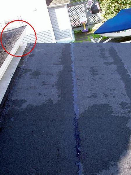

          1. BigMish | Jul 30, 2009 04:15pm | #6
            Photos
            PeteDraganic | Jul 30, 2009 04:45pm | #7
            in the pics it almost looks as though you roofed from the top down and that your seams are upside down.... maybe it is just the pics?

          4. PatchogPhil | Aug 05, 2009 01:13am | #26
            I suspect that the water is originating from above your new rolled roofing. The roof section above your flashing looks pretty bad in this photo, circled in red by me.
            Looks like water could get in/under that white edging material and then travel inside the overhang structure. Could also be spilling over the higher roof section, running down and under the eave (water can "hug" a wall/ceiling) and then inside your new flashing.
            Pull off your new "flashing", after running the hose on the roof section above the new rolled roof. I'll bet you see water behind where your flashing is located.

          5. seeyou | Aug 05, 2009 01:28am | #28
            That looks like built in gutter filled with dried out tar.http://www.quittintime.com/      View Image
          6. PatchogPhil | Aug 05, 2009 03:05am | #29
            It appears that the outer-most edge is higher than the roof inboard from it. That would "dam" a lot of water that percolates down inside the overhang and finds it's way behind the new flashing.

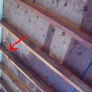

          8. BigMish | Jul 30, 2009 05:34pm | #10
            Not sure? Is that possible? Any way I could check?
          9. BigMish | Jul 30, 2009 05:40pm | #11
            I wish it could be humidity but upon sober reflection it's really just too much water; the rafters are dripping, there is water pooled on the ground below the drip.

            I think a problem exists at the flashing. If rain is blown at the flashing it could get in at the creases I am seeing as well as at the screws. I would slip a counter flashing under the wood molding to cover the top of the existing flashing and coat all the screw heads that are exposed with a good caulk.

            I would tend to agree with dam inspector that the vulnerable point is your flashing against the wall.  Is the flashing embedded in anything or did you just lay it down on top of the roof and the wall.  If so the trouble shooting would be pretty straightforward.  Grab hose and work you way up the roof.  If it does not leak just going directly on the roofing materials, the spray into the wall flashing. It looks like it can get under the flashing .
            One of the reasons I suspect it is the flashing is from the underneath images, the wetness begins at the first plywood seam except at one rafter where it runs up higher.  I would bet there is joint in the plywood.

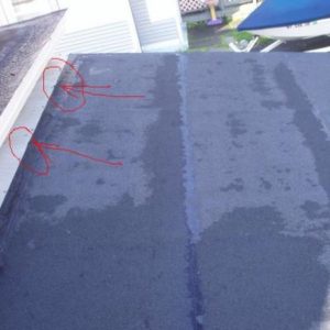

          13. Piffin | Aug 04, 2009 11:59pm | #20
            I think you have it right. I don't know how he sealed the metal to the roofing, but it is full of puckers and fishmouths top and bottom.Why would he think that if 4" oc nails is necessary on the laps, only 12" is OK on the metal?I do see another problem too tho. Gotta go baCK AND LOOK MORE AT ALL OF THEM
          14. theslateman | Aug 05, 2009 12:03am | #21
            Paul ,
            That metal is under a 12 " overhang .
            Walter
          15. Piffin | Aug 05, 2009 12:22am | #24
            I can see that.He also said it was an extremely hard rain, but I have seen flashing like that leak in a normal rain from splashbacks. I don't know how mucch is running off from the roof aabove either or if it is bleeding down over, but I don't doubt some of the problem is at the flashing.

            That's his description, but you can see in the photos that it is quite wet, has been wet before, and will keep getting wet until he fixes the flashing

          25. Piffin | Aug 09, 2009 01:12am | #39
            but the plywood is wet right at the topI thought I saw a crack too. Some of that stuff looked old already.

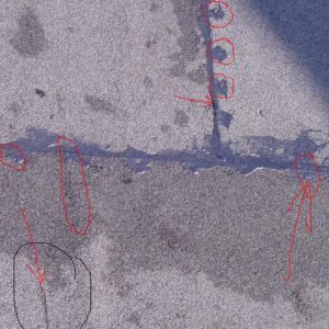

  4. Piffin | Aug 05, 2009 12:14am | #22
    In your photos, it is so obvious that water can be getting in at the top of the flashing I won't detaail that, but I think there are other spots too.
    Also, you did not mention having used any tarpaper under the rolled roofing.
    In these photos I detail some pukers in the metal that appear they might be near the point where you first see water from below.
    and then I detail where i think you have a crak or cut from a knife in the surface of the 90# and where I can see nail heads thru the tar indicating that might be a probelm now or become one in a year or so.
    I never expect more than five years from a rolled roof like this. sometimes I get luccky and see ten
