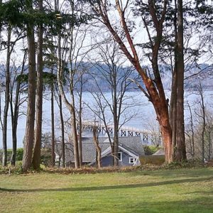

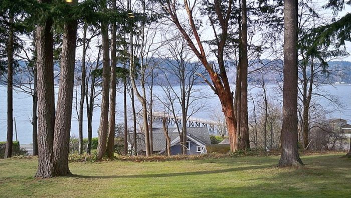

    1. sapwood | Mar 07, 2009 01:08am | #34
      "...keep a close watch over your field."Now that won't be a problem. I'll be watching over it quite a lot. It's the west yard and behind it is the view that we're paying for.
        Sphere | Mar 07, 2009 01:14am | #35
        Be a real shame to mess up that view with MT. Poovius, thats for shure.  Whrere ya at? Reminds me of Carolina pines.Spheramid Enterprises Architectural Woodworks
        1. sapwood | Mar 07, 2009 01:34am | #36
          Puget Sound, Seattle area, Bainbridge IslandDidn't think we could afford a water view lot, then this one came up and we jumped on it. The house is a real fixer-upper. Fortunately, I know how to do that.
            Sphere | Mar 07, 2009 01:39am | #37
            Well, my guess was close! LOL  Nice view, good luck with it all.Spheramid Enterprises Architectural Woodworks
