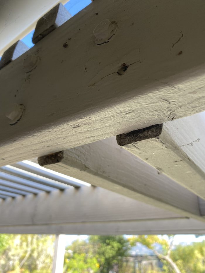

Outdoor arbor – near side is 2×6 ledger screwed into roof rafter tails, then doubled 2×6 beams supported by 6×6 posts on far side, with 2×6 joists and 2×2 trex spaced on top. Ledger to beam was three 3″ deck screws through ledger into end grain of beams. After a few years the beams started to sink downwards by 1/4″. I jacked them up and used 3/8 x 4″ lag screws. After a few more years the beams sank again by 1/4″ with the lags angling downward in the ledger. My proposed fix is to use 3/4″ maple dowels through the ledger and 4″ into the beams, grooved and ends chamfered for good glue bonding.
1. Will this work? 1, 2 0r 3 dowels per beam?
2. Should I put a 3/8″ lag in the center of the dowel for added shear strength?
3. Is there a better method given that I don’t want to use metal joist hangers because of appearance.
Thanks.

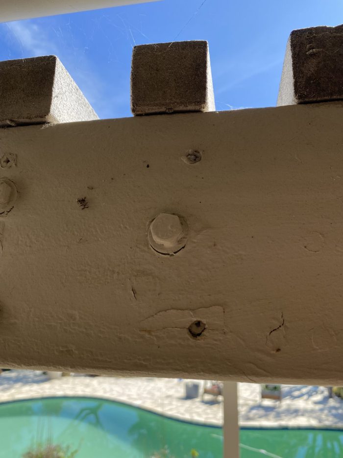

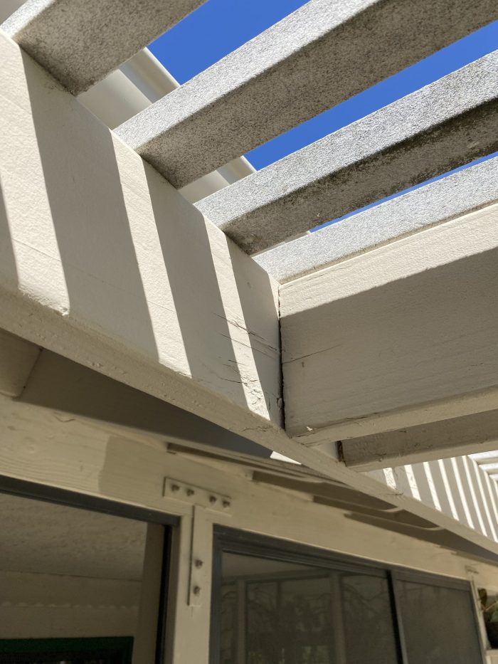

      Thanks for reply. Beams are good, no rot. Span varies from 5-10'. You can see the lag screw head tilting downward with the weight. My theory is that by doubling the diameter from 3/8 to 3/4 and having a glue bond between the dowel and the ledger it will not tilt. I don't think shear strength is the issue. Your input appreciated.

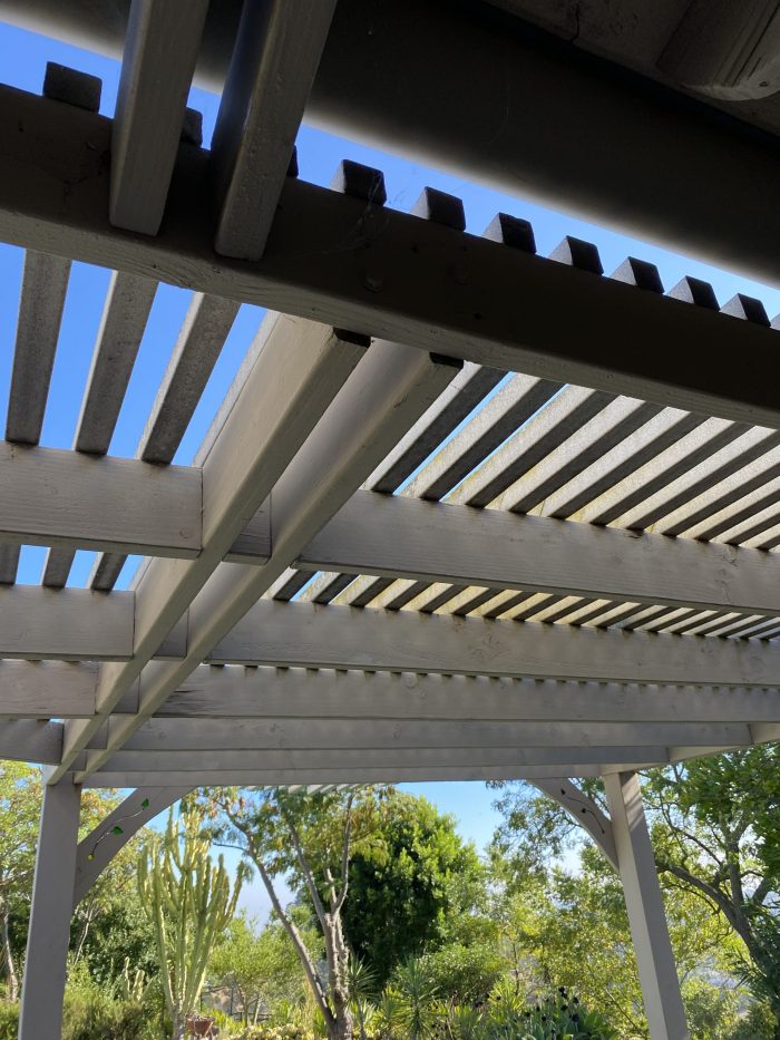

    2. calvin | Oct 11, 2024 03:43pm | #4
      Step back an take a few more. I understand the move you mention but am having a hard time seeing where all this wood is going?

    Front and back of the ledger/beam joint. 3/4" maple dowel would replace the lag screw.

    1. calvin | Oct 12, 2024 07:44pm | #6
      I was hoping you show the whole structure.
      Something is moving this.

    Looks like too much of a load for screws into end grain. Several dowels might be a bit stronger but maple is not a rot resistant wood and would decay fairly quickly. Some kind of a metal hangar is really the best solution without tearing the whole structure apart.
