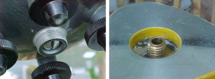

Check this picture (attached) and tell me…
What’s missing?
David White level base and robotoolz tripod.

See if the david white's male end is reversible or possibly removable to accept the tripod mounting screw.
No, the DW threaded end is part of the base of the unit. Molded.
But I hadn't checked that, thanks.View Image
Have you checked to see if the screw in the level base allows you to take the male thread adapter out leaving you a 5/8- 11 female threaded area? I made an adapter from a 5/8 inch 11 thread/in bolt drilled out and tapped 1/4-20 so I could use my builders auto levels on a heavy duty camera tripod.
Take the screw out and whole thing just falls apart.
Cool idea making an adapter for a camera tripod. That would allow easy elevation, wouldn't it?
This is actually a DW level with bad optics that I am trying to use for a base for a Robo torpedo level. View Image

I've seen them, but thought it would be grand to recycle the old David White into something useful. But that may be where I end up.

Apears to be different threads on each, so get a union to fit each. Cut them in half and weld or glue together. I bought a camera tripod for my robovector for $18. Works great for under houses.

I have a little more info right now than I did when I started the post.
The Tripod is a standard 5/8"-11 thread.
And the David White is 11/16"-26 thread. That one may be hard to find.
But I like your idea.
I'm thinking there must be a factory made adapter to make this work, but haven't found one yet.
I've Googled and eBayed and Yahood till I was blue.View Image
Bee, the tripod mount in the right picture looks just like my Stabila.......is there is a hole all the way through the screw for a plumb bob string?
If you take the screw out of the bottom of the DW mount, can you get a piece of 1/4 x 20 allthread and use that to:
A. hold the DW mount together by putting the allthread in where the screw is now and put a washer and nut on it? then
B. with the allthread continuing through the tripod mount with another nut and washer on the bottom, can you tighten it to the tripod?

Got it figured out....
There is an adapter to make this work. I even found one on the net for $13 plus postage. Just a female 11/16"-26 X female 5/8"-11 coupler, (or is that a union?). Too much for what it is, but that is to be expected.
There was some talk about there being a part missing, but from what I can tell, most builder's level adjustment screws bear on the tripod top.
But all the auto levels have a base under them.

Call David White which is now Cst Berger I believe. Ebay usually has the base for lasers for $39. I keep forgetting to look at my David White but my Sokkia just has a 5/8 - 11 tpi hole in the base.
bee, on some of the tripod setups i've seen, there was another part that screwed onto your leveling base, it had a thin sheet brass plate and a center screw.. the center screw was female to go over your instrument center screw and was also female on the bottom to receive a standard tripod mounting screw
it was made of brass so the 4 leveling feet would wear the brass out instead of themselves.. in your picture you can see the bottoms of the leveling screws are worn.. with the non-existent brass sheet , the brass would have the indents from the leveling action..
in other words, i think you are missing a part ( duh )
bee,
I've never used much four-screw equipment, but I've never seen an instument without a base plate. I think Smith's correct; you're missing a piece.
