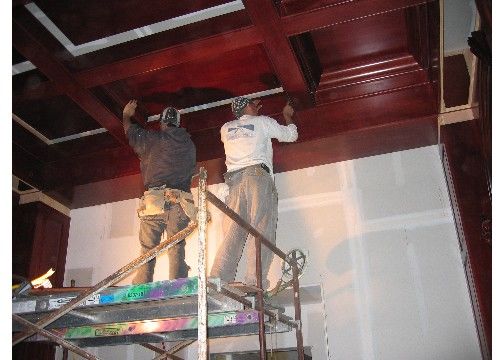

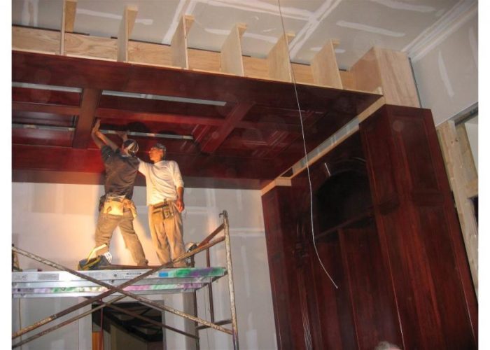

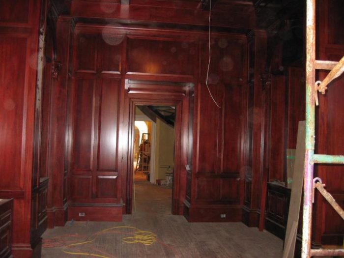

Here are a few photos of a library install we’ve been working on for the last couple weeks. It’s all prefinished mahogany.
Any suggestions on why I am getting these white circles showing up in my photos?

Those spots are from a growing organism on the lens coating. More than likely on the inside side of the lens. The seal in the lens has broken down. If the camera is still under warrenty change the camera out. 200 proof denatured alcohol will kill it and you risk damaging the coating further

I have some very exotic expensive lenes that have done that. After a while crystals will start to form. The flash refracts thru the growth rings. that's why you can see them.

I'm familiar enough with the type of lens phenomenon that One Putt referred to, but that's not what I'm seeing in those library pics, either. Airborne dust maybe, but I'm gonna say not likely judging from the type of refraction revealing the lens aperature. That sort of thing IME is nearly always repeated in a linear fashion pointing to the light source or sometimes is just a single spot, but not the type of toatally random spotting seen in the library pics. That's gotta be either airborne dust (room doesn't look that dusty in general), or caused by dirt on the exterior of the lens or the now explained.......petrie dish.

Nice looking work! I believe your photo problem of white circles is fairly simple. I assume that you took these using a flash. The circles are simply light reflecting back from dust in the air. Attached is a photo I took recently in a granular product storage warehouse. It was a very dusty environment so this is an extreme case. See if these circles are not similar to what you have.

I suppose IMERC could be right, but I seriously doubt that all these folks suddenly have cr@p growing in the lenses.
It's more likely do to bright lights and shiny surfaces. Id imagine you've noticed that sometimes movies or videos wil have rows of spots like that, often octagonal or hexagonal.
That happens when sunlight falls on the surface of the lense, and it reflects inside the lense body. The shape is a product of the leaves in the lens aperture.
That's what this looks like, and could be produced by the flash reflecting off that shiny mahogany, or by a bright worklight too close to the frame.
