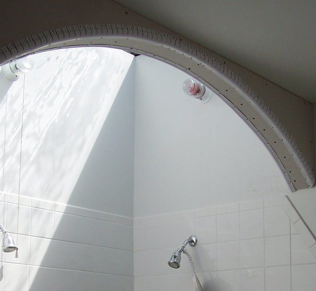

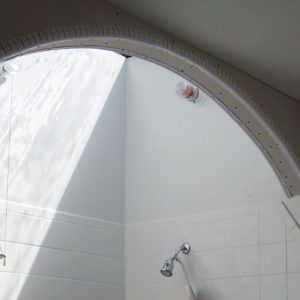

I've used 'jelly jar" cheap porch lights from Depot - our big shower has four of them, at like $7 apiece.
Forrest

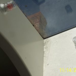

Pic - one red, to make skin tones more natural. or, to be more technical, to improve the R9 value of the CRI (Color Rendering Index)

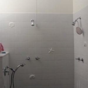

Got more pictures of that shower?
Just these - I'll go take some more as soon as the kids get through tonight - they like it better than their bathrooms with the claw-footed tubs and curtain surrounds - imagine that!
Forrest
Edited 11/13/2009 9:25 pm ET by McDesign
Nice. Thanks.

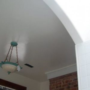

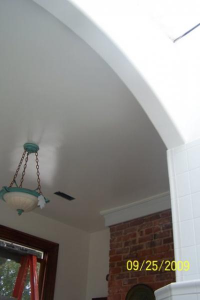

More - it's a mess, cuz we're painting the room. Don't tell DW I posted pix -

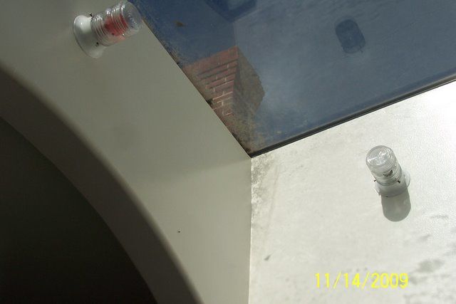

Taken from outside, on my scaffolding - View Image

Here's a clearer pic of now (yeah, I know the skylight's dirty) -

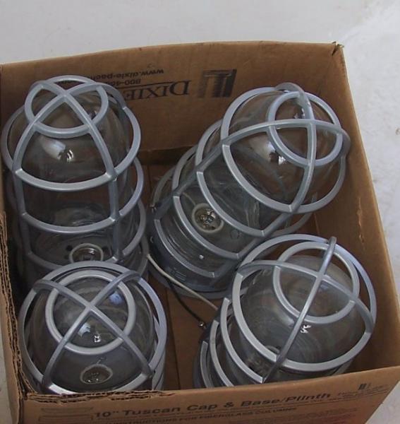

Here's some cool architectural stuff (tested samples) I got from work that I'll put up tonight. They're like $80+ retail; I just took them out of the recycle trailer and pulled all the thermocouples off, and reassembled them into a matching set of four. Look like they came from a submarine
