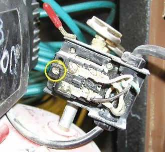

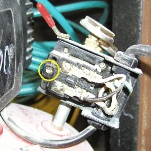

I didn't see the cfm rating either, but that isn't a big deal for something like this. What I did notice is the pressure cut-in is set to 75lbs, which seems low.

There are a lot of times a small compresor would be fine, it is just that the low cut in pressure would cause problems with fasteners not setting, like brads in hardwood, etc.

Qtrmeg,
I haven't seen this particular compressor, but on all that I have owned the cut-in/off pressure switch is adjustable- on my shop compressor there is seperate adjusting screws for both cut-in & cut off points. My little PC pancake compressor has one screw that adjusts both. It was under a dab of what appeared to be hot melt glue, makes me wonder if the heavy vibrations causes it to self adjust without the dab of glue holding it in place... we shall soon see...I attached a pic of the pressure switch & circled the adjust screw...
