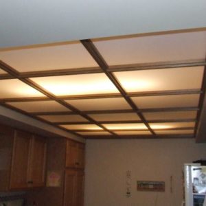

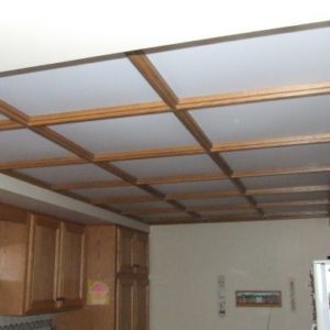

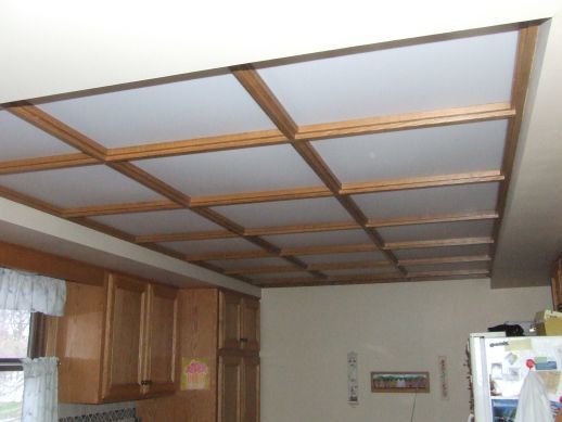

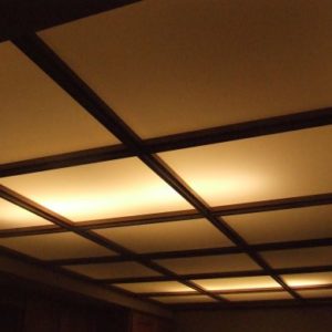

Here are some shots of our kitchen ceiling —
It’s an oak grid with acrylic panels.  Above the panels are currently 3 dual-tube 40w T40 4-foot fixtures, mounted to the ceiling.  The ceiling is 7 inches above the acrylic panels and 5-7/8″ above the top edges of the wood grid.  The panels are 2 feet by 2 feet, making the overall setup about 6’3″ by 13 feet.
As can be seen, the middle fixture is not working properly, and replacing the lamps did not fix it, so presumably the fixtures are at end of life.  (They’ll be 40 years old this fall, and are on their 3rd-4th set of lamps.)

         Take a look at e-conolight.com.  They have a 40" LED under cabinet fixture that produces 917 Lumen and is 2700K.  I don't know if that's enough light to replace what you have on fluorescent.  Maybe 4 fixtures to replace the 3?  I think BigAss fans makes BigAss Lights now too.  They may have a utility LED that would be plenty bright, maybe not the right color however.
