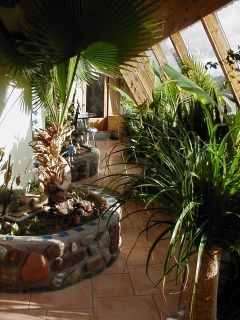

    Friends of mine built an Earthship house off the grid and use their gray water - it's ALL gray water - to water the garden in the house in winter and also outside in summer. They use soap that degrades to essentially fertilizer for the plants. The bathtub is on a raised platform to facilitate gravity flow.
    Their Biolet toilet uses PV to run the fan to evap the urine. It doesn't smell the slightest bit and the product is compost for the garden.
