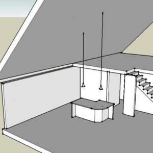

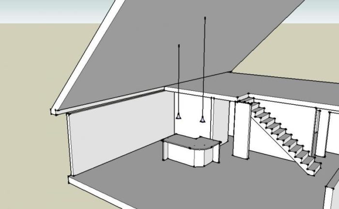

Have you had experience hanging small task spots from ceilings that are way up there?
Take a look at the attached.   What we will have is a small kitchen island to light with two spots, hung from a 12-pitch cathedral ceiling.  The longer of the two runs is almost 13 feet.
Has something like this worked for you?  What was used for the suspension?  A tubular downrod?  Chain?
