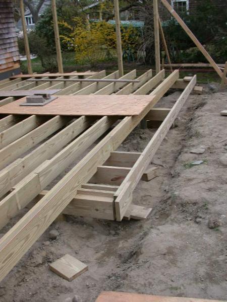

What I usually do is make a hinge point attachement to deck and float over 12" of crushed or washed stone, but for this one as you describe, I might look at cantilevering the 2x6 out fron the 2x12 which are already supported on a foundation.
we ran the beams out to form the first step.. and built the deck on the beams.. spaced the beams so our decking only needed 2x8.. and the beams were built-up 2x8.. worked pretty good..

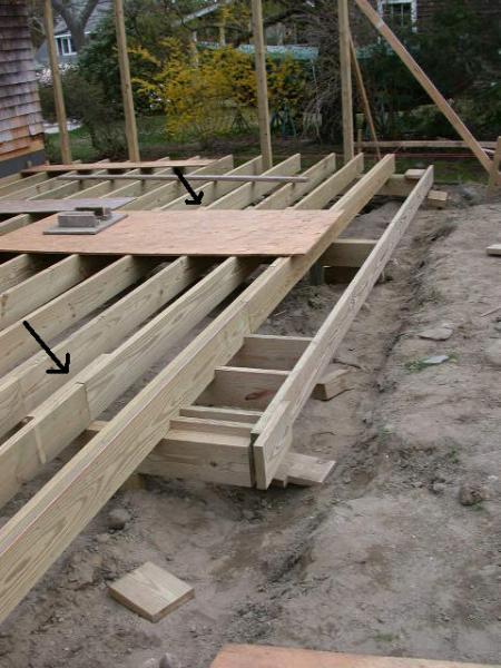

Do you always butt the floor joist into eachother and nail a block along side them where the arrows are that I put in your picture? Just curiuos.
Joe Carola
no, joe... not always.. but in this case we wanted the SS. screw heads to line up exactly all the way across the deck...Mike Smith Rhode Island : Design / Build / Repair / Restore
