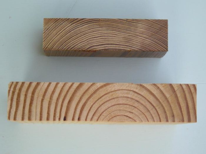

In the attached photo, at the top is what lumber dealers call longleaf pine.  It  is from a joist that came from an old warehouse, probably at least 60 years old.  I’ve got about 140 bf of it.  Nice stuff once I cut away all the nails and useless parts.  Below it in the photo is what my local lumber yard sells as southern yellow pine, just a common construction 2 x 6.  When I googled “longleaf pine” it says it is another name for southern yellow pine and goes on to describe the locations, needle shape, wood use, etc.  Are these the same species?  If so, why the dense rings on the older wood vs what is sold today?  Have the old trees been harvested to extinction?  I’ve also heard longleaf pine referred to as “heart pine” – same questions.  Hope someone can clear all this up for me – life is tough enough without being able to talk smart about pine lumber.

    The difference is old growth verses plantation grown. There isn't  much old growth left and hopefully no more will be felled. The plantaion is quickly grown and there growth rings show this by being farther apart.
    Old growth is very dense and when gotten the way you did acceptable to use. I doubt pine is will be put on the endangered list any time soon tho.

    Longleaf, or "heart" pine, or "antique heart pine" is all gone - trees were gone 75 years ago.  Good book http://www.amazon.com/Ecology-Cracker-Childhood-World-Home/dp/1571312471 talks about it.  Great gal wrote it - she and I were both HS senior STAR students for our respective GA regions; she in 1980, a year before me.  Didn't meet her 'til 25 years later
    Like Rez, I keep what I find or remove.  Wonderful to work with - I sometimes think of it as machining aluminum.  Modern yellow pine is nice and sturdy, but farmed and not the same.

    Long leaf pine was a very good flooring wood in its time. Its pretty tough.

    Long leaf pine is a distinct species,Pinus palustris, but it is included with the SYP group. I get to work with a lot of this great wood. Just got a load of 10x12 and smaller beams to do some framing with. Got some 10x12 fir also.

    Longleaf Pine is great wood and is a very interesting tree, but it is just one of the "Southern Yellow Pines" (Shortleaf, Loblolly and Slash Pine are the other common species). Heart Pine is from the center of old, mature trees of any of these pines. The heartwood has a darker color from resins deposited in them and are harder and relatively decay resistant.
    Most modern, plantation grown, pines are harvested before they are old enough to even develop heartwood. The wood is grown faster and has far fewer growth rings resulting in softer, lighter, weaker wood.
    The Old Growth conditions (more trees crowded together) caused intense competition for nutrients and especially sunlight. This resulted in slow growth (lots of small growth rings) and dense, hard and strong wood with few knots.
    Longleaf Pine is a fire adapted species. Seedlings look like a dense tuft of grass and remain looking like a clump of grass for several years...all the while they grow extensive root systems and store up food for a surge of growth that turns the stunted seedling into a gangly sapling growing several feet tall in a single season.
    The "grass" phase protects the tree from fire in a moist green covering--able to resist fire damage from surface fire. The sudden surge upward in the sapling phase lifts the trees sensative buds above the threat of grass fires.

      Greg,Longleaf Pine is not a sub-species of SYP. Longleaf pine is one of the SYP species--it is a species in its' own right. Nice to hear about your pine planting project. Very cool.Longleaf pine stands were some of the last Old Growth in the South. The advent of steel hull ships in the late 1800's and early 1900's caused a steep decline in demand for Naval Stores. Up 'til that time the large old Longleaf Pines had more value alive than dead.Longleaf Pine and Slash Pine stands were spared the ax and tapped much like the Sugar Maple in my neck of the woods, except for turpentine and pine tar used to make wooden ships watertight.Some of those last remaining stands of Old Growth fell as recently as the 1950's. Spared for centuries, only to drop ironically as iron replaced wood.

        Just as sort of a recap:  I take it that longleaf pine is its own species within a group of pines referred to as southern yellow.  There are longleaf pines being grown now but they are plantation grown, widely spaced and harvested much earlier than in old days.  Longleaf pine from long ago, all cut by now, grew wild, usually in dense stands, slow growing which made them dense and hard, often many, many years old when cut.  The wood looks good, smells good - too bad it's gets more and more expensive as it gets harder to find.  Thanks to all for the info.

            No.old longleaf is denser than new longleaf.Old STP is denser than plantation grown SYPand old virgin white pine is going to be denser than newly harvested white pine.but simply being virgin growth does not overcome the species differences.To put it into your cook and gardening background - There are new types of corn that are very sweet and even keep that sweetness instead of turning it into starch. This makes newer corn on the cob more satisfying than what I grew up with.There are also new ways of growing tomatoes, such as hothouse growing ( which ruins the taste, IMO) that produces different palatability compared to the old heirloom varieties that are sometimes ugly to look at.In this example of the new corn being better and the new tomatoes being worse from changes over the centuries, neither kind jumps a special barrier . You only compare the change within the species.
            Sphere | Nov 18, 2007 10:35pm | #44
            Old Growth, new growth all of that is still dependent on RATE of growth, and that is determined by competition.
            As the natural (not plantation) "virgin" forests cycle from deciduous to coniferous, the amount of sunlight varied the rate of growth.
            Competition for water in densly crowded setting also meant less actual summer wood being produced and what was, was compressed even tighter by the next few decades being added.
            Extremely wet yrs can be spotted in just about any tree as can the drought yrs.
            It is ironic in a way that the same slow growth rate that makes SYP a superior board than one fast grown, it is the opposite in a species such as Red Oak, the tighter the rings the more "brash" and brittle the sample is, faster , wider rings mean more flex and give...strength.Spheramid Enterprises Architectural Woodworks
