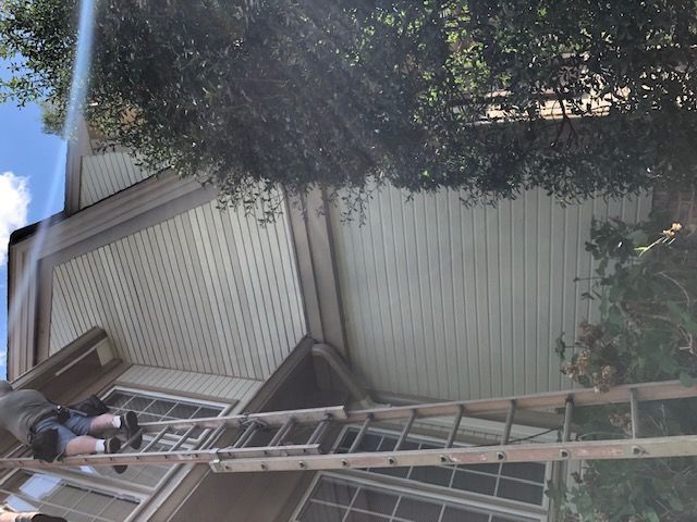

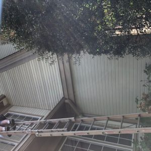

    Hello. I realize this response is about 8 years old, but I finally found a solution to replacement my masonite 5" dutch cove siding.
    Let me say first that as long as you keep masonite in good condition (painted and caulked), it looks good - like real dutch lap siding, and has an R-value, unlike many fiber cement boards. But recently I had a problem with water getting behind the masonite where the gutter attached to my Dutch Colonial home.
    I replaced the masonite boards which come in sets of three planks with Boral TrueExterior 1'x6' dutch cove boards which come in 16' lengths by trimming and routing each of the boards in a table saw to match. The Boral is waterproof and rot proof.

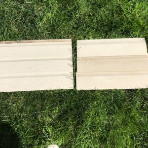

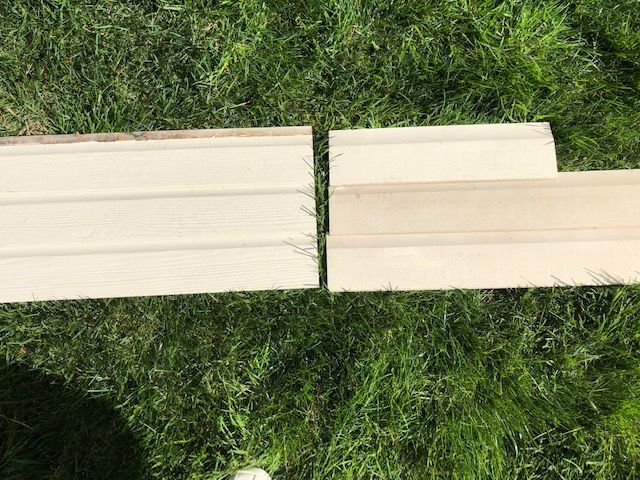

    In the first photo, the masonite is on the left, and the Boral boards are on the right. Note that I also used a small rounded router bit and sander to smooth the bottom edge of the Boral

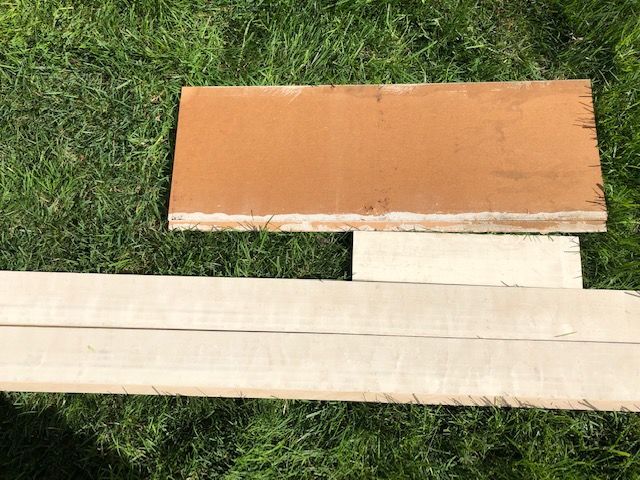

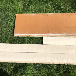

    In the second, the back of the masonite is on top, and back of the Boral boards is on the bottom (in addition to trimming/ripping them shorter as well as the notch).
    In the third, the masonite is on the bottom/right, and the Boral was replaced on the top/left. Note that I have not yet painted the Boral to match. The photo is showing the Boral as primed at the factory.
