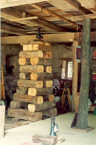

I figured if you were in the neighborhood, I could loan you some jacks, but you aren't very close (central PA).
I purchased a RR jack at a flea market and several screw jacks at public auctions. Cribbing came from a tumble down barn (with permission of owner).
Looked like this last time I used them:

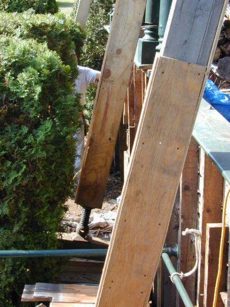

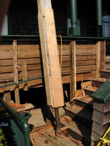

we use old building mover screw jacks.. the boxes are 2x6 nailed up round-robin...Mike Smith Rhode Island : Design / Build / Repair / Restore

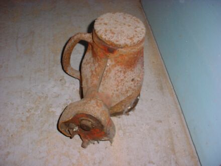

Here's an old grandpa hydraulic:
Where on earth did you find that?
Came from a defunct dock company. Was broke and my brudder played with it and got in working again. Comes in handy for heavy weight with a low opening.
