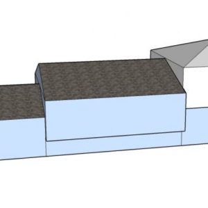

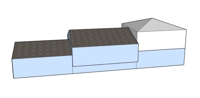

    1. JMadson | May 30, 2009 01:13am | #5
      Like this?
      Original
      addition?
      1. baartman | May 30, 2009 01:52am | #6
        I think there is a major question that should be asked... why is the house not suitable for the long haul. The outside look to a house is only one part of many for a renovation of the magnitude you seek.
        Edit to clarify post!
        If you need a bigger kitchen then out the back on the right or if a bigger master bedroom (with ensuite?) the the garage option or out the back in center.... I'm just throwing ideas/food for thought.
        Edited 5/29/2009 7:21 pm ET by baartman
        1. JMadson | May 30, 2009 04:08am | #9
          5 in the family and just 3 bedrooms. Minimal storage space as well. Could we live here forever? Sure, but a little more room would be nice.
          1. baartman | May 30, 2009 04:44pm | #12
            Adding more rooms would make it hard to look good and functional. Can you change the hallway to back to front?

      3. alwaysoverbudget | May 30, 2009 03:47am | #8
        well sorta what i was picturing,except instead of the roofline continuing at the same angle , i was picturing at the ridge having a 6' wall up and then a new
         gable roof line on it.but extending out the back like you have drawn
        i can see it,but i don't know how to draw it on the computer!

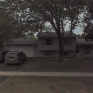

    1. JMadson | May 31, 2009 04:32am | #22
      Here's a house near me, do you like it?
      1. john7g | May 31, 2009 05:19am | #24
        If you hipped four sides of the upper level roof the stepping won't look so bad.  I've got a model with it form yours but things are a bit inaccessible right nbow during my data backup process.
        1. JMadson | May 31, 2009 05:32am | #26
          John,
          I don't speak roof, I'm just a simple woodworker.
          What do you mean by "If you hipped four sides of the upper level roof "?
          joe
          1. john7g | May 31, 2009 05:52am | #28
            sorry I was speaking while realy tired.
            Try thinking hip roof.

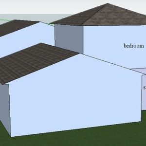

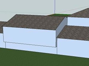

          2. JMadson | May 31, 2009 07:23am | #32
            What about this?
            The addition would be offset to the back to minimize the impact. The large tree in our front yard would hide most of it as well.
          3. john7g | May 31, 2009 02:24pm | #35
            The problem with the stack in the back is that you're going to eat up a lot of SF (in relation to the total addition) wiht the stair run.  You need to use the existing stair location (I've a reversed stair before during extensive remods) to maximize your SF.
            I don't think you're going to get 2 BRs into the 15ft depth very comfortably.
          4. JMadson | May 31, 2009 03:48pm | #36
            It would only need to be one BR up there. We've got three, just need a forth.
        popawheelie | May 31, 2009 06:40am | #30
        No I don't. It looks like three separate buildings stuck together.
        There are ways to unify the three levels though.
        Imagine that house on one level with exterior treatment uniform all the way across.
        Pretty boring I would say.
        So having different levels is actually a good thing if it is pulled off.
        It adds a third dimension to the building that I think is exciting.

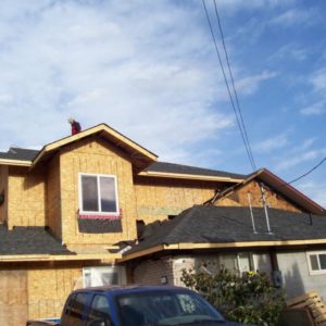

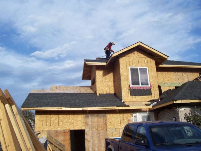

            popawheelie | May 31, 2009 08:32am | #34
            It's not done yet. I was just trying to show that there are ways to make most designs work.
            The problem is figuring out what will work before you actually see it.
            It takes creativity to see it. Looking around helps, but eventually it has to be created by your imagination. "There are three kinds of men: The one that learns by reading, the few who learn by observation and the rest of them have to pee on the electric fence for themselves."Will Rogers

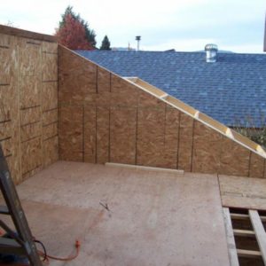

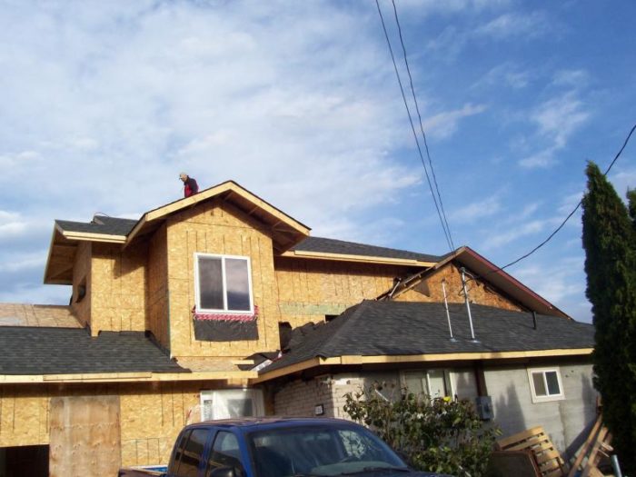

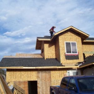

    1. silvertip | May 31, 2009 04:14am | #20
      On the back half of my garage I put in a deck.  I left the front trusses as mono pitch and put a gable end truss in this gives me privacy from the front street and from the neighbours.
      1. silvertip | May 31, 2009 04:19am | #21
        Here is a front view of the garage.

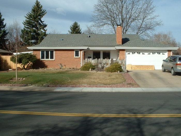

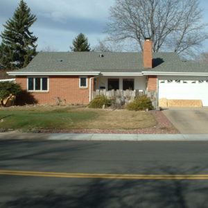

        1. JMadson | May 31, 2009 07:20am | #31
          Left is all garage, stairs in the garage go to the lower level in the middle section
          Lower middle section is one giant family room (best feature of the house) with a small bathroom.
          Upper middle is two bedrooms in front, each the same size roughly. Master is back on the left and the two bathroom make up the back right. The hallway goes down the middle from left to right.
          Right is half kitchen (the back half) and half living room (the front half). There is also a basement under the right side.
          From the inside, our best bet is over the garage. Easiest stairs and least disruptive construction. Anything built up on the left would have stairway issues IMO.

    1. JMadson | May 31, 2009 04:30pm | #39
      Jack it up and put in a lower floor
      The whole house? If so, I love it. Still looks the same, just a little taller. Probably won't happen that way, but I still love it.
  10. JAlden | May 31, 2009 04:58pm | #41
    Put your MB over the garage, but not the entire garage. Stay back from the left side by maybe 6'. Leave that part of the original roof there to minimize the mass.
    Extending the garage left even a few feet would help. The upper wall could then line up with the garage door.
    So it would be about what 16 feet wide by 20 deep?
    Right side of the house is kitchen, dining room? Kitchen in the back? Bump that straight back and expand the kitchen and have your screened porch. Gable roof back from the existing ridge.
    Move your front door to the center where the window is. Add a portico/little porch roof over it. Sidelights on the door.
    OK, Last. Add a third window in your downstairs family room between the two that are there. Outside of there have a nice garden area on the way to the front door.
