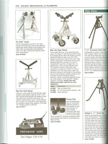

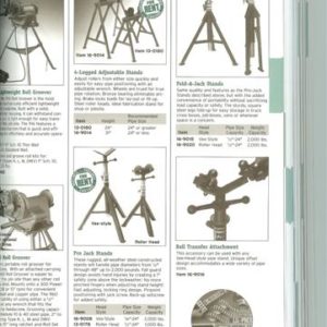

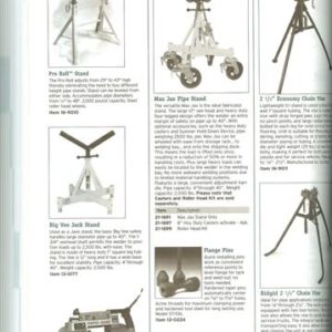

  7. notagain | Jan 03, 2006 02:52pm | #17
    Colony Hardware
    New Haven, CT
    They ship
    1 800 698 0781
    Edited 1/3/2006 6:53 am ET by notagain
    1. geebee | Jan 04, 2006 03:18am | #25
      Believe it or not, I had a reason for liking the "tripod"-type supports (even though these had four legs). Being that this is California, we do get earthquakes around here. My physics tells me that it's harder to knock something off a pyramidal support than a block, especially a block that's not solid (i.e. a pile of cinderblocks and shims.) My little plastic jacks have weathered at least two groundshakers, and the shed hasn't toppled off its "foundation" (although one jack DID collapse and a couple more were damaged.) Plus, I liked the idea of retaining easy adjustability. I have had to adjust the jacks in the front a couple times, when the doors to the shed started sticking. Ground settling? I don't know, but it was easy to adjust!
      The jacks from Colony Hardware look like just the right thing! I haven't checked the pricing yet; that might ruin my day...
      Thanks to all for your help and suggestions! JoeH, if you ever get the opportunity to find out where the jacks you mentioned come from, I'd love to know.

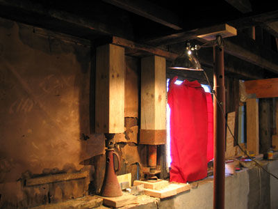

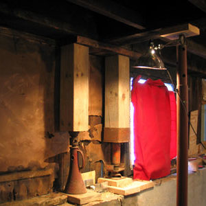

        1. davekaplan | Jan 07, 2006 08:22pm | #30
          glad to see you found it george. those look pretty good. nice price!For the sake of screw jack discussion, here's an image where i've got a shoring jack and a Simplex screw jack. There's an American Tool Rental in Chicago where i rented a bunch of the Simplex jacks when I needed to do some lifting. They've got a lot of tools you'll need once or twice for rent: http://www.rentalhq.com/MemSiteNav3.asp?alt=AMERICANRENTS&pg=PLSimplex is my favorite brand of screw jack. http://www.tksimplex.com/screw_jacks.html. I found the shoring jacks online... don't know the brand, they're staying in the wall.
