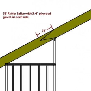

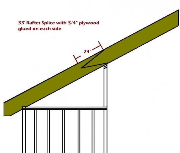

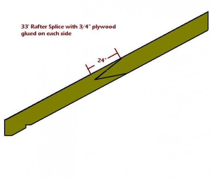

i’m framing a house right now and the rafter lengths are going to be 33′ without tails. the builder doesn’t want to special order so i’m going to have to splice. in the past we’ve always used whatever stock we’re using for the the rafters to sister alongside the splice. today my lead man was telling me that the last place he worked they just used plywood to cover the joints and stapled the devil out of it. i’m open for suggestions. seems to me the builder is not really saving money with all the material involved in splicing, bracing etc. oh, by the way we’re working with an 8/12 pitch. we should be ready to start cutting rafters on monday. i’d really like to hear from you guys. thanks

          i agree that's exzactly what i'm gonna do Framer. but nobody has answered about what my lead man told me about splicing with plywood and liquid nail and staples as opposed to using the same 2x stock we're going to use for the rafters themselves. believe me i'm going to reinforce the devil oit of this roof. good thing about it all is there's no snow here in the desert.
          1. Piffin | Jul 06, 2005 05:01am | #12
            Side splice OVER the intermediate bearing wall. Any other splice doesn't count for sh!t!The wind still blows in the desert. Never hear of wind loads?

            "...nobody has answered about what my lead man told me about splicing with plywood and liquid nail and staples..."
            In my opinion, it's ridiculous. Rafters shouldn't be spliced.
            I suppose technically it's POSSIBLE. But you would have to design the connection correctly, with the correct size of plywood or lumber scab. And the fastening schedule would have to be specific about fastener size and spacing. But I doubt anyone would go to that much trouble.

          3. Notchman | Jul 06, 2005 04:02pm | #27
            Joe Carola provided the best splicing method.  In addition, you should have collar ties.
            Supporting the span over a knee wall and installing collar ties breaks up the span to reasonable lengths that can be pulled off the IRC (or equivalent) span tables for rafter live loads for your area/region.

            but nobody has answered about splicing with
            I can't find any sort of reference to permissible splices in 6 pages of goole search (other than for truss member significantly shorter than 33').
            I want to recall an old old tome on framing suggesting that a framing splice wanted to be a third of the span and the same depth, and stitch nailed to a specified fastener table.  Not really very close to putting some PL on a 2-3' gusset of 3/4" plywood.
            Now, just to see, I plugged some numbers into the sagulator--a 369" x 1.5" x 11.25" fir "shelf" bearing 990# (30# for 33') deflects 2.87" almost a quarter of the member's depth.

            If the break is gonna be over the knee wall then sure,   if they want to use plywood instead of 2x material why not?  Not sure how much you'll save since you'll need to size the plywood so it isn't proud of the rafters, then  cut the plywood to length, glue, staple and etc.  sounds like it would take more time than grabbing a 2x and nailing it in place.. multiply times  the number of rafters that need doing and you'll have an idea of the added costs involved..

            Albert, I'll take a stab at this - if there is no mid point bearing, forget it. If there IS, then the purpose of the splice is to stop the bottom portion sliding off the roof, right? If so, then I reckon that 3/4" ply nailed and glued to both sides should do it.  2 times 3/4" = 1-1/2", ok. I wouldn't vouch for just the one side.
            I would NOT put the splice where there's shear: a 2x has all the grain going one way, but ply has only 4/7ths going the one way (3/7ths is cross-grain), so it would only be a little more than half as strong.

            An acceptable way to splice a 33’ rafter would be to just lap them. For instance, to reach 33’ plus a tail you could use two 20’ and have a 4’ lap yielding a 36’ board to start with.  Or use any combination equaling 40’ lapped 4’ with the intent of bracing the rafters at the spliced area over a bearing wall.  I have built knee walls on pitch for loooong slopes only to find my slab/foundation was not perfect and then take measures to fix it.  Yes, you have to raise them (spliced rafters) up to flat when bracing but if the bracing is at an angle and not plumb it is not hard to do.  I do not make any layout adjustments when splicing these rafters as the 4’ sheathing will not be affected enough to matter.

            We aren't disagreeing as long as you put the splicce over the supporting wall. A six inch splice would be enough there, but if there is no support under it, the splice will not hold the end of the joist against the loads no matter how you do it.

            You are prabably OK b ut I wouldn't let the snow pile up too deep on it. The problem is not one of the rafters sliding downhill. It is that you have a sixteen foot rafter spanning 18' if I understood you rightly. That means that the only thing supporting half the load of that section of roof is the nails in that little bitty one foot overlappping splice because the beam is moved on down a couple more feet from the end of that rafter. so you are asking that each splice and what - ten nails or so? to suport about 586.67 pounds figuring for a forty pound live load and a fifteen pound dead load.

            I think the responses have overlooked the obvious.
            The original poster is not really going to have a 33' rafter. He will have two rafters that equal 33'.
            My response is this: splice them anyway you want but put a bearing wall, or bearing snow brace, under the splice in a way that carries each section of the roof.
            It might be easer to put the bearing wall in first, but then again it might be easier to do it later, depending on your carpentry skills and techniques.
            You will not be able to adequately splice a 33' 2x8 and prevent it from deflecting in a very substantial manner. It will be like trying to stand up limp spaghetti.
            Have fun!

            Blue,Your last post is baisically the samer as my last post. I know it's a rafter that totals 33' and I said to him to brake the splice on the bearing wall. So if he does that he will have a 33' rafter. He must have a 27'5-1/2" run if his rafter totals 33' but somewhere in there he has a bearing wall that he can break he span on.Still framing it like what he's saying is ridiculous and yes it can be done later but I don't care what technique you have or how fast you are, you know this situation with this limp spaghetti rafters it's not going to be faster Blue.Joe Carola
          38. Piffin | Jul 07, 2005 02:13am | #36
            his mention of any bearing wall under the spaghetti rafters was almost an after thought - oh yeah, sure - I'll put in something like that more or less kinda sooner or later. Notice that he can't say where the wall will go, only that he might build one later on. The reason I get so flamed up about stuff like this is that I see the HOs later, when they call me to fix the work hacks do like this. I tore down one to rebuild that had 26' rafters to a ridge that was not ecven structural. The rafters were spliced the way you drew but with an eight penny nail in each point and side scabs only occasionally. He had used ( wasted) 14' lumber to do it. The resulting 'roof' had a three inch sag in it, and walking on it reminded me of native blanket rituals AKA trampolines. Building like this guy wants to do is equal to stealing money from people because they do not get what they think they are paying for.
            Apparantly in this case, the owner is party to the cause, but no carpenter with a conscience could possibly go at this roof this way.OK Venting over. I feel better now.
          39. Framer | Jul 07, 2005 02:35am | #37
            Piffin,I know by now that things are done differently all over the country but still when people ask questions like this or other structural questions it just gets to me because we can't do anything here in NJ structural without Architectural or Engineered plans. It's either these people are doing it without no permits or their states they can do whatever the hell they want to do.What this guy is asking is a complete joke. If a builder told me to do something like this even if he was paying me by the hour I would tell him jump off a bridge but I would never be in this situation because we all work from plans. That's why so many times when I here questions like these I ask what the plans say and most of the time they wont respond back.But I'll try and offer what I think is right so maybe some of these people are not dumb enough to do something that can kill someone.If this guy has a bearing wall underneath all he has to do is give us the measurement to it and then I can draw a picture for him need be and give him the rise of the wall and the rafter length for the first rafter and then continue from there.If he doesn't respond back I'll know he has no intention of putting a wall under the rafters that sits on the bearing wall and he's going to do what he wants anyway. Permits required or not no matter what state your from people should be smart enough to check with an Architect or Engineer to be safe instead of ripping out a lally column in the basement because they want more room or taking out a 16' bearing wall holding up the second floor walls,ceiling,rafters and layon valley from a gable addition.OK Venting over for me now too. Joe Carola
          40. Piffin | Jul 07, 2005 02:45am | #38
            On the other side of that, I have almost never lived and worked where structural engineering was required to get a permit. But gimpy work like this rarely happens because word gets around.
            The good book says that with some men, their sins go before tham, and with other men, their sins follow after them.
            Reputaion means a lot in both our worlds of building.

            i had a long talk with the builder and told him how it was gonna be if he wanted me to continue with the frame. i told him what i would do and would not do. i explained all this politely and courteously and would not budge from the stand i was taking . in the end everything is going to be alright. many thanks to everyone who voiced opinions and suggestions and may God be with you all as you do your work to give you even more skill and efficiency that your businesses may prosper to new heights.
            Albert
