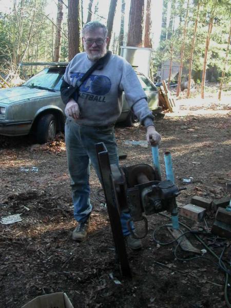

Luka came down yesterday and we got his winch put together from scraps laying around the yard. He still needs to connect up the 1/2 HP vintage Crafstman motor, attach the old roll of 7/16 cable (DW says “you need to give away more of this junk”), chain the 8″ channel to a tree, and he is ready to go.
Quite a winch head, double worm gear drive, looks like 2000:1 or better ratio, v-belt drive should work OK, and Luka plans on taking the motor indoors at night to avid theft – hopefull when full of cable the winch will be heavy enough to “not try to walk off” by itself.

And if anyone attempts to steal my funky looking, but great winch.... I'll just weld more heavy metal to it. LOL I think something like a car hood should slow them down. he he he

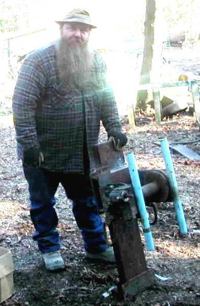

Looks like it oughta work. I did have a thought regarding speeds, which MIGHT be easily workable. You know how some drill presses and/or lathes have stepped pulleys to change speeds with?Like on the motor, there's a 4", 5", and 6" pulley. Then on the other shaft there's a 6", 5", and 4" pulley. (In reverse order)The point is, you switch the belt to dofferent pulleys to make the output shaft turn at different speeds. I wondered if you could rig up something similar for your winch, so you weren't stuck on one speed.

That is already exactly the plan.: )Well, not exactly. The winch is geared to take so many turns to get a bit of revolution on the reel, that I have a larger pulley on the motor. And a step pulley on the winch. The step pulley will give me 3 different speeds. Starting at just slightly faster than 1 to 1. Hopefully the smallest will give about 2 and a half to 1.
