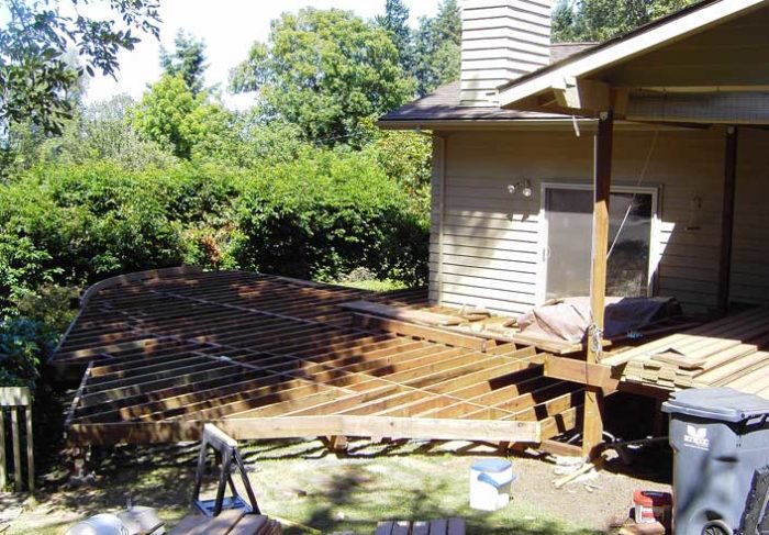

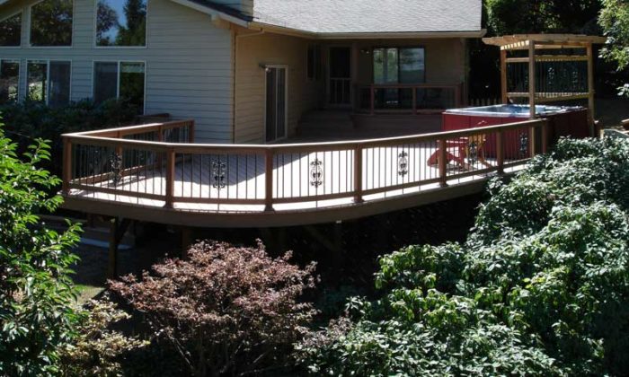

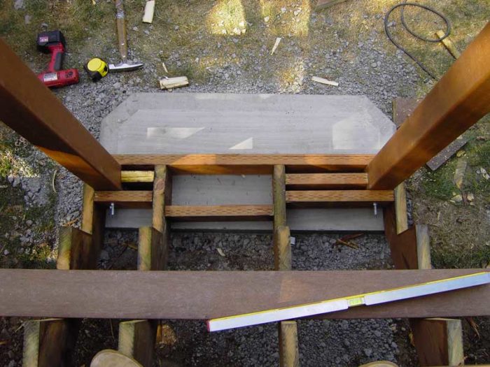

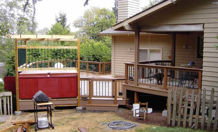

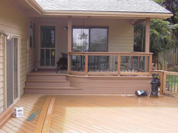

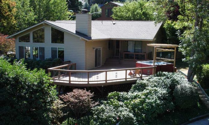

Thought I’d post some pics of a TREX deck I completed last month.
Structural was pressure treated, joists were 12″ o.c. due to angled decking
cedar pergola over the hot tub
TREX Accents Saddle decking and handrail
Deckorators Classic Series aluminum balusters
I found a guy that does quasi-aerial shots using a 35-ft. boom and remote controlled digital camera. I was pretty impressed with the final shots. It’s nice being able to get an overview of the project. The embedded pics are from his boom – the linked ones are mine from during the build.
