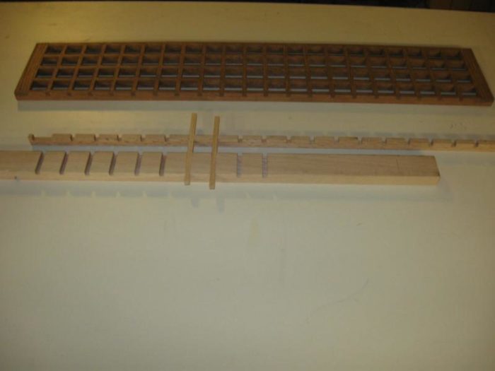

Spent an afternoon this week making this:

Does that go in a wall application or floor?

Thanks Mitch,This is for a wall. They still need to paint the wall cavity flat black, before I install it.

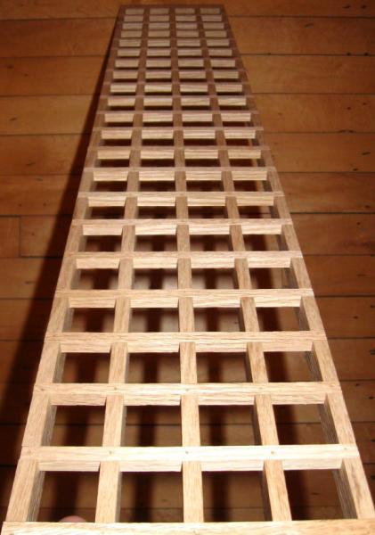

An architect had me make this air return cover years ago.
I didn't care much for the real louvers showing from behind...

Thanks,Yours looks nifty. Could the metal grill have been given the flat black treatment?Bass
<Could the metal grill have been given the flat black treatment?>don't see why not, good idea!http://www.tvwsolar.com

Just grilling me, I see.$120 for a 6x32, unfinished$180 finished.
I've got three of those I gotta make in the next few weeks -- waiting for lousy weather so I can justify shop time vs. getting the exterior stuff done. Two of them are currently covering holes where there used to be returns, but are no longer used. I figure I'll make the grids out of oak like you did and fill where the voids used to be with something dark, like walnut, so they'll still go with whats there and in use.
Nice job. How did you space the slots (which I assume you cut on the TS with a dado) -- freehand or use a jig?

Hi Mike,I did use the a Freud dado head, set for 5/16". I used 1-1/2" centers as that number divided into both the height and width evenly (6x32"). In this case, since I only made one, I skipped the jig step. I marked my centers and aligned the marks between the two outside blades of the dado set (the inside edges of the two blades met right at my marks, so I just went with that method).I did the final planing of the purlins for thickness with the shallowest of passes (so they just fit the dados).
Thanks. That's pretty much what I intend to do too.Mike HennessyPittsburgh, PAEverything fits, until you put glue on it.
I cut from dadoes from the middle to the ends, and used the fence as a reference, run, flip, run... two dados per set up. The miter gauge does the work and just skim the fence (warning no pressure on the fence, and fence and miter guage perfectly perpendicular to each other and fence dead-on parallel with the blade). I had no issues, but it is because I have a strong desire to keep all my parts in good working order... and to not mess up the work.All the best,Bass
