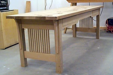

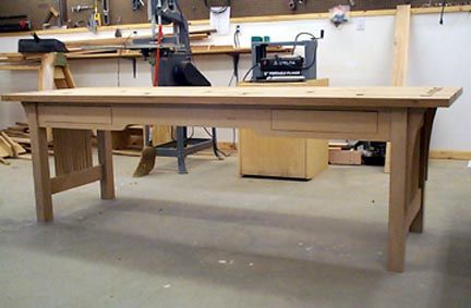

My job is stalled between sitework and foundation building while my concrete guy catches up with others. My friend Jack bought some white oak, quartersawn, and I designed and built him a desk/worktable. Here it is, partially completed. Top is 1-3/8 x 30 x 96, and will have an array of butterfly inlays at the board joints. Legs are 2-3/4 x 2-3/4, quartersawn faces all four sides, put together with lock miter corners.
Looks very cool Micro.
Beautiful, wish you were local.
Way too cool. Sometimes the only way you can tell who your true friends are is when you're moving or building something. Those friends that pitch in and lend a hand show what true friendship is all about. By doing this table for your buddy you must qualify as a true friend. You're owed more than a six pack and burgers for this project!

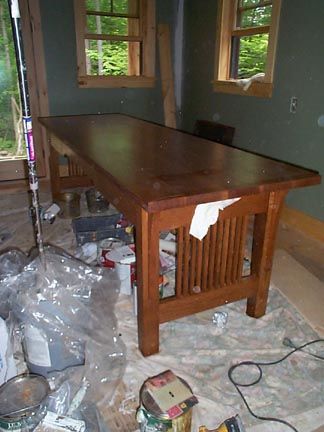

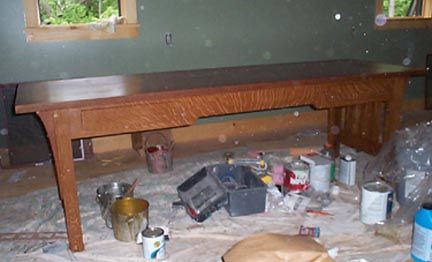

Jack's painting sub stained it and put a couple coats of clear. The hardware is yet to be mounted.

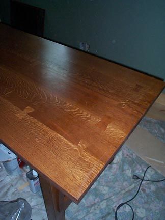

The closeup shows one of the top corners, and exhibits some butterfly inlay work. All hairline joints, no filler. There is a slightly oversized accent inlay on each end of the top that I wanted to do in rosewood, but it kept breaking bits, so I used cherry. All the rest are in the QS white oak used for everything, including the drawer boxes.

looks good but ya got some TP stuck on the one end there!
