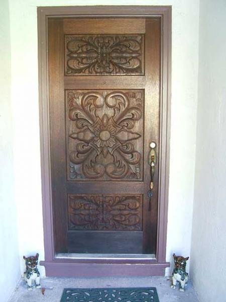

This has been a good thread for me, because I'm planning on refinishing my Mahogany front door. I do have the right conditions - although it's on the West-facing wall it's set in 4' from the wall, and the whole front wall has a 6' porch so no direct sun or rain hit the door.
The door has 3 carved panels - kind of a rustic/Spanish look. Some of the end-grain on the carving is a bit rough, and I've considered sanding it down but wonder I would lose some of the rustic look. It currently has a couple of coats of Varathane Natural Oil Finish, and looks pretty good (the finish iws 2 yrs old).
I'm having trouble seeing how spar varnish would look on this door - it seems to me that it would be too glossy - the Varathane is almost too much as it is.
Here's the door:

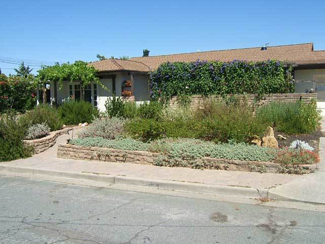

And the front yard, for context (formal it's not!):
