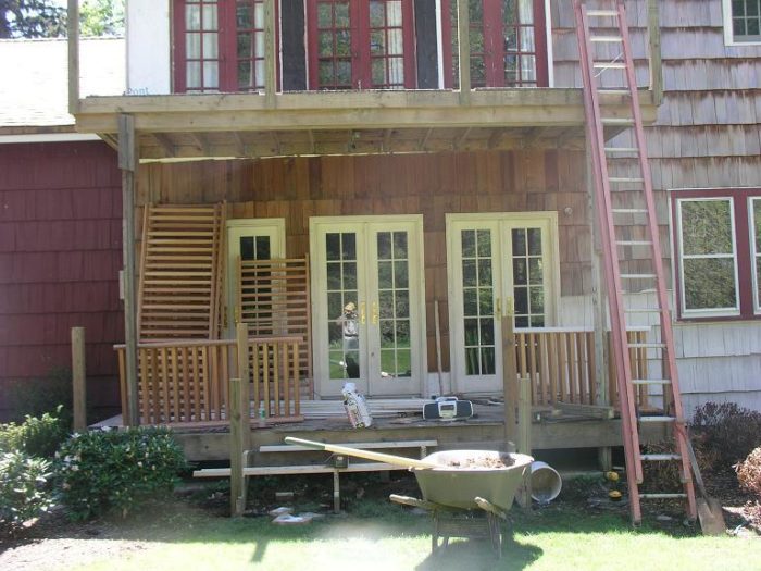

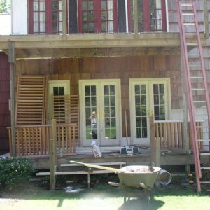

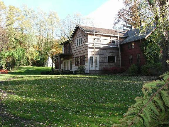

I’ll be laying down three 5/4 x 4 T&G mahogany porches in a cpl of weeks.
Two of the porches are over the ground but one is on a second floor over one of the other porches.  PICTURES ATTACHED
The underside of the 2nd fl. porch I’m using beadboard soffet.
Originally I was going to go over some 3/4″ Advantech I laid down while framing. Was gonna put down a rubber torch down roof under 5/4 x 4 sleepers…naturally the whole roof will slope away from the house approx 1/4″ per foot (Porch goes out 8′ (8×18).
Thing is I framed the porch up too high…ugh…I have approx 4″ from the top of the Advantech to the entry door. I really don’t want less than 4″ from the top of the finished mahogany porch to the floor in the house because snow and rain seem to beat that side of the house most frequently. Am I being overly paronoid?
Can I use the t&g mahogany with nothing under it. Nail directly to the floor joists?
Will it leak water onto the soffet and deck below? Or will it stay relatively dry below like a boat keeping out the water?
Or am I in a dillusional dream land? OK forget that…the question above then ~~
Am I being too paronoid about having only about 1 1/2″ above the mahogany porch floor on 5/4 x 4 sleepers?

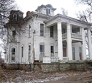

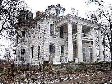

          I'm not using mahogany, but I need to install a floor on a second-floor porch deck.  I've already installed a tongue-and-groove beadboard ceiling directly to the bottom of the joists.  My concern is water infiltration from the floor above.  There is a roof above the second-story deck, which offers some protection.
          Photo is attached below.  It's a 1915 classical revival porch on an 1870s house.  To me it looks like a silly anachronym; if it were my house I would rip it off and build an appropriate Italianate porch.
