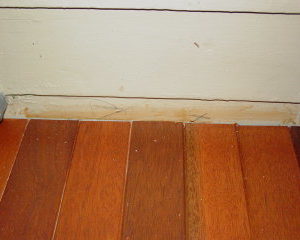

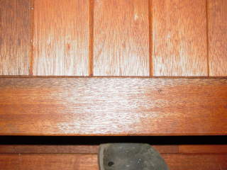

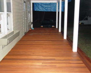

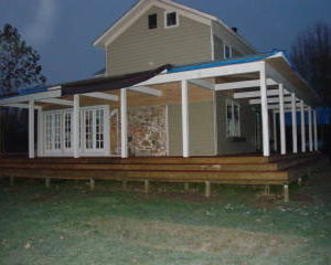

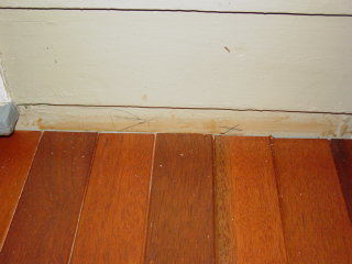

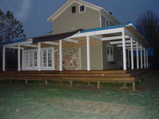

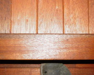

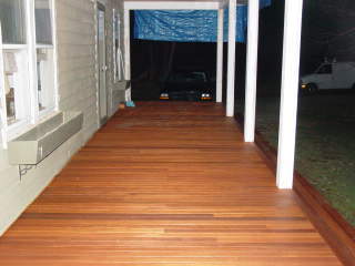

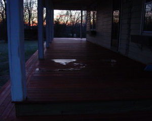

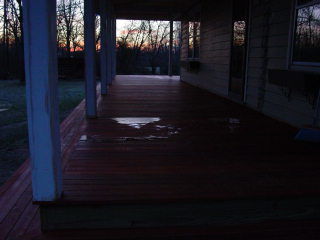

The porch has NO SLOPE, I verifed last night. I used a 4ft level, and reversed it to verify (an inaccurate level would compound the error if flipped end for end, right?) I checked parallel to the house, as well as perpendicular. Dead on level. Since it’s 8 feet wide, it needs an inch of slope, right?
I don’t know how that would be accomplished where the porch wraps around the side, but that’s why it wasn’t done by me. 🙂
I poured 2 gallons of water SLOWLY on the floor to see where it went. It didn’t. It stayed there, and even froze overnight, and was there this morning! (uh, oh…)
The porch IS under roof, but it’ll NEVER be entirely dry. In fact the water can still reach the house walls in a driving rain.
The pics are as follows: 837 is the entire porch from the corner. 832 is the house side of the flooring, typical. 833 is the stair side of the flooring, typical.828 is the side view of the front floor.843 is the ice that formed overnight when poured last night.

        To verify, I slowly poured 2 gallons of water on the floor, to see if it had any tendencies. it didn't. It didn't go away, or towards the house. It froze overnight, and is still there, two days later. Water isn't going away on this thing.
        I think it's too expansive to NOT have a slope, since it has no walls at all, so water is going to be VERY common. But, since this wood is really almost impervious to water, it might be best to simply protect the house from it, no?
        I'm not sure what ice will do if it forms in large amounts.

            now that enclosing the porch does not sound so painful  - sounds like a must w/ your barnyard friends -  don't forget to incorporate more of those multi light french doors so prominent on one side of your house    maybe you could get lucky and find 20  3 X 5' old multi light single pane units to compliment the doors
            looks like w/ the blue tarps something is in transition w/ your roof    sister on some rafters to extend your eaves and you will get better lines and maybe your steps will be covered
