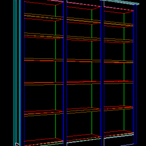

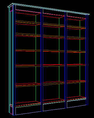

    Here is a pic of a bookcase they will deliver soon for me.  Three identical KD carcases, faceframes to detail out each end and hide the fasteners, and a big KD faceframe for the front.  The shelves are fixed and have hardwood front edges 3/4 thick by 1" high.  Everything is primed and ready for finish in the field.
    (Sorry about the duplicate pic.)

      Micro- What would be the price they'd charge for that unit?
    2. Frankie | Jan 20, 2004 05:34pm | #3
      What are the dimensions of the whole bookcase, what's the lead time and how much did it cost?
      I went to the web site and carcass pricing is not available from a price list - only drawers and doors.
      F.
      1. gdavis62 | Jan 20, 2004 09:50pm | #4
        70 w x 82 h x 10 1/4 d, carcases and shelves of primed MDF, primed poplar trim and face frames.  Don't have a breakout on price, unit comes as part of a large order, and discounted accordingly.  Your mileage may vary.
        Contact them for pricing, and ask for Leon Scherr.  I designed this one, and gave him my drawings.
