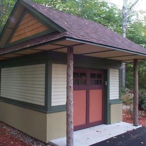

I’m thinking of making a pair of 7H x 9W overhead garage doors.  They are being quoted at such high cost to me that the make-it-yourself option seems better.  I can get my garage door guy to bring in all the hinge, track, etc., hardware, plus openers, and do the install.  I’ll just be making the 21″ H x 108″ W panels, each 84″ tall door having four sections.
Exterior finish is alkyd primer and acrylic paint.  No windows or glass.  Just flush, with a stile-and-rail arrangement of applied wood boards.  I have done this before, but am thinking of changing the design slightly.
Each panel is a stressed skin box consisting of a stile and rail pine core, faced with plywood inside and out.  Here is what I did for the door in the attached pic.  The core frame is 5/4 white pine, using 5-1/2″ boards ripped to 2-5/8″ to make stiles and rails.  Each panel has the 2-5/8″ surround, and one intermediate vertical center “stile.”  Outside facing is 3/8″ grooveless T-111, and the inside is 1/4″ luan.  Exterior trim is 3/4″ western red cedar.
I’m thinking this time of using 1/2″ 5-ply MDO plywood for the exterior skins, and maybe 3/4″ pine for the core frames, instead of the 1″ 5/4 material.
My material costs are about $450 for wood, glue, fasteners, and paint.  They can be made and primed in one full day, then finished in two two-hour painting sessions on successive days.  If I value my own time at $75 per hour, I am saving about $800 by going this route.

  1. butch | Aug 06, 2005 02:20pm | #1
    Not to change the subject...but...
    That is one fine looking shed.
    Do you have any more pixs. of that????

    Do your panels merely butt to each other or do they over lock as they would in a factory door?

    Great looking doors and shed. Consider your design stolen.

    1. gdavis62 | Aug 06, 2005 08:41pm | #5
      Forget needing to M&T the stiles and rails together, if you are doing a plywood sandwich like mine.  I just pocket screw 'em.  Anything works that will pin the core frame together all aligned, ready for the skins.
      When skinning my frames, I run a bead of polyurethane (Gorilla or clone) glue around the perimeter, and up and down the intermediate stiles, then just staple on the skins.
      Be sure to place additional blocking where you'll be attaching hardware.Gene Davis, Davis Housewrights, Inc., Lake Placid, NY
