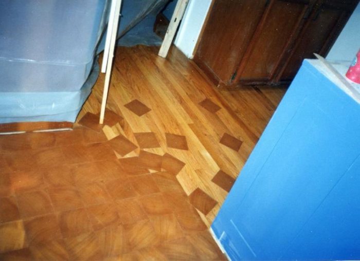

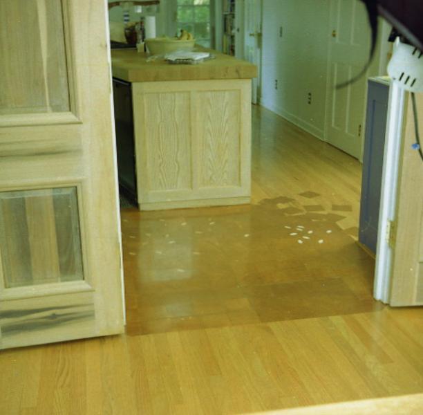

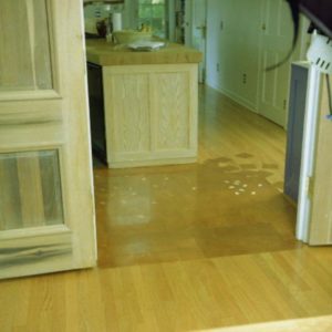

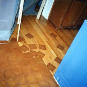

        1. jimblodgett | Feb 21, 2006 05:47am | #24
          Here are couple shots of an endgrain floor I put in for a customer a few years ago.  Cut the tiles from 6x6s.  Piece of cake.TIPI,TIPI,TIPI!
