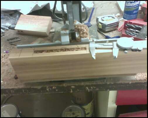

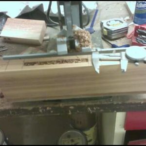

    Using a little Delta mortiser, I power the cuts 1-5/8" deep for the 1-1/2"-long tenons.  Here is a cut for the bottom rail tenon.  If you look at the pic you can see two lines left of the mortise, one depicts where the mortise chisel is sighted for the end of the cut, the other is where the rail cheek will end.  I leave a 1" horn on my doors, and cut them off later.

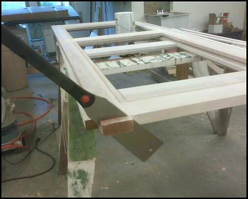

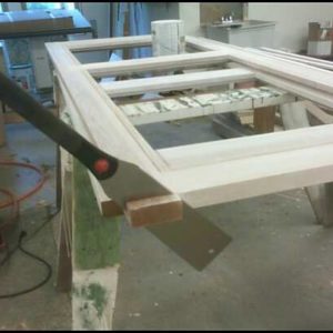

    I skipped a lot, but two doors are made and have been primed with alkyd.  You can see the saw I use to chop the horns.  I could have used power, but by the time I get the tool, run the cords, etc., I can have them sawn with a handsaw.

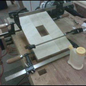

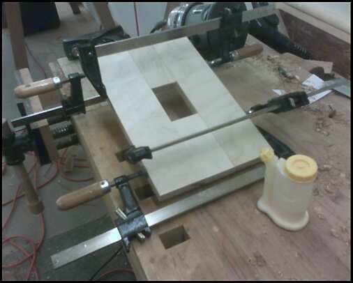

    I could not find, in my mess of a shop, my old hinge mortise jig, so I am making another one, for the nice Ives 3x3 oilrubbed bronze hinges I'll use.  I just ripped some baltic birch ply to reglue into what you see here.  I'll screw a sidestop on later.
