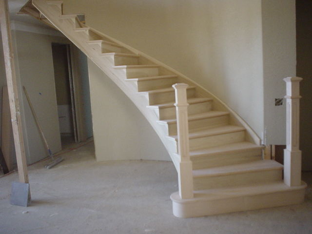

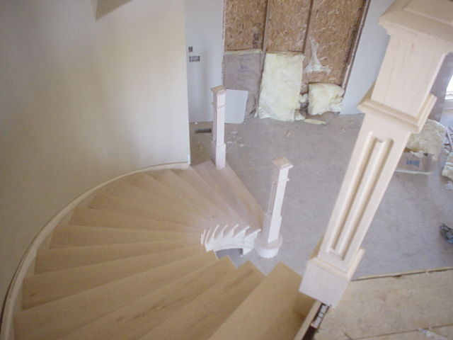

I set a maple curved stairway today. I will install the railing next week. It took 6 guys to set it in place. The outside stringer fit real nice except for one two foot section where the framing bulged out. It was only about a 1/4 incha away for the two feet…and the rest all lagged up airtight.

Hey Stan, when you say you "lag" the stairs, what exactly do you mean?Glad to hear you're still happy makin' 'em, cause I'm still happy lookin' at 'em<G> "But to be honest some folks here have been pushing the envelope quite a bit with their unnecessary use if swear words. They just put a character in to replace a letter. But everyone knows what they're saying." Sancho
Snort: I put lag bolts through the outside stair stringer into each stud underneath the treads.
I first drill a 3/8 hole for the lag bolt.....then stick the spout of a a construction glue tube into the hole....and while tightly sealing the hole....I ineject the subfloor adhesive. Then the lag bolt gets inserted and the glue gets all squished out making a very stout adhesion. I could actually take the lag bolts out later and it would be just fine...but of course I dont.

The fit to the wall is excellent, do you have specifications for the builder to adhere to?
Also the box newel panel looks like it was made with a router, the inside corners are rounded. Is that possible? or was it piece built to look that way?

Red: To be totally honest....the fit to the wall was nice except for a two foot section where the framing in the house went out of curvature. Nothing that a little mud wont fix....
I had laid out the curved walls on the floor...but the framer didnt follow my arc very well.
Those newels were off the shelf...cant claim to have made them.

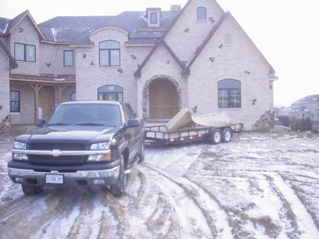

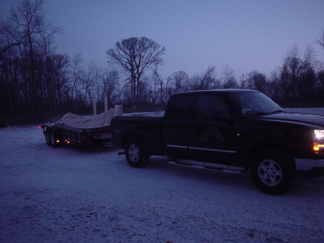

Stan, I gather you work by yourself fabricating the stairs, but who helps you install them. Do you use the same person(s), or do they differ from job to job.
TGNY: I just get a half a dozen locals to come out for $20 each to take the stairway out of the shop and onto my trailer. It takes them all of 5 minutes...they are happy with $20 and so am I.
I have the contractor supply about 4-5 guys the day I set it in place. I take along a part time guy that helps me for whatever part of the day I use him. I pay him hourly from the minute he leaves the shop..till he gets back to the shop. I pay much better than they can make locally. They also get a breakfast and a dinner.
I have had several people comment about how I can afford to pay $20 per person for 5-10 minutes...sometimes 10 people on the big ones. I just kind of chuckle how they can think that $200 is going to make any difference at all on compared to the price of the stairway. If I figure a stairway that tight that an extra $200 is going to make or break me....then I would have been out of business two months after I started. <G>
