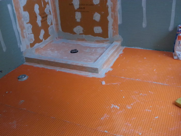

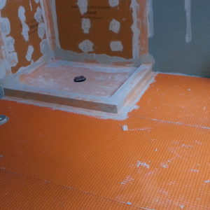

  2. amazingman | Dec 17, 2013 06:08pm | #2
    tile job
    I agree with the half  plywood .But x the backer and use kerdi matt it will allow for some movement in substrates
    Mongo | Dec 17, 2013 10:32pm | #3
    You can't use a cement board directly over plank subfloor.
    You already have 3/4" plank subfloor. On top of that I'd add 1/2" plywood, screwed. Over that, Ditra. Which is what the previous poster was calling "Kerdi matt". The Ditra is about 1/8" thick. Ditra will help protect the marble from any floor movement, and with this being a bathroom, Ditra is waterproof, so the underlayment and subfloor will never see water.
    If that added elevation (1/2" ply plus 1/8' Ditra) works, great. If you need to go higher, go with a thicker plywood.
    If you do use wonderboard, do not forget that you have to bed the wonderboard in thinset. ie, you'll have your plank subfloor, then your plywood underlayment, then thinset, then cement board. The thinset is not for bonding the cement board to the plwood. The screws do the fastening. The thinset fills any void between the plywood and the cement board, eliminating any micro-vertical movement of the cement board. The thinset is not an option.
    Good luck!
