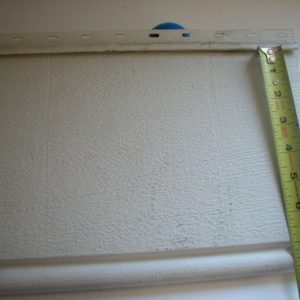

match aluminum siding/straight 8/beaded
JeffBuck | Posted in General Discussion on June 30, 2004 02:04am
anyone know where this stuff came from?
can’t locate anything even close yet …
and that’s all it has to be … close.
will infill between 3 windows where old/flat ply failed …
will have to replicate it out of cedar if all else fails …. vinyl would be fine if it matched the profile … or a hardi type product. Don’t need a lot ….
Straight 8″ exposure … wood grain … bead at the bottom ….
Thanks,
Buck Construction, llc   Pittsburgh,PA
     Artistry in Carpentry
Edited 6/29/2004 7:11 pm ET by Jeff J. Buck
  1. Shep | Jun 30, 2004 04:54am | #1
    Jeff-
     Good luck!
       Last time I needed some alum. siding to do a patch I went to my siding supplier, who told me that very little alum. siding is made anymore. There's just no demand for it.
      I cleaned him out of the siding I needed ( he didn't have much anyway ) just in caseI needed a few pieces for another job. He told me he probably wouldn't replace them, anyway.
      BTW, I don't recognize that profile. Maybe one of the others here will. You're probably going to have to duplicate it in cedar, like you said.
      JeffBuck | Jun 30, 2004 05:13am | #2
      I calles one place ... so and so's aluminum siding factory outlet ...
      said I was on my way to match up some siding ...
      "Oh, I doubt I can help ya ..."
      I said .. Oh sorry .. did I get the wrong extension ...
      "No ... we just changed to vinyl in '74 and never changed the company name ...."
      so I drove to my old stand by .... the guy laughed ... they carry only 2 styles ...
      said that's all I was gonna find in the whole area. They're the guys everyone else buys from .... think I'll be making something myself.
      How the hell does an 8 year old house end up with aluminum ... I think the builder was still working from the stuff he bought in the 70's and warehoused?

  2. renovatorbob | Jun 30, 2004 06:29am | #3
    Jeff, I have ggod news and bad news.  The good news is that I can identify the aluminum siding.  It was manufactured by a company called US Aluminum.  the bad news is that they are no longer around.  I used to work for an insurance restoration company and my job was to track down and match siding so thats how I know.  As far as I know, you'll have to go with a Hardie type product because all of the beaded vinyl are only 6" laps.   you may try calling an ABC seamless dealer to see if they have a die for their machine? Just a thought.
