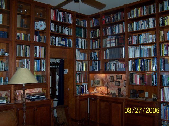

    We've had good success with Behr European Cherry (water-based) on birch to approximate our heart pine.   Note - use pre-stain conditioner first if birch or maple!
    In this library, all the trim and cabinet door frames and ornamentation is longleaf pine flooring (from elsewhere in the house) with just Formby's clear tung oil finish, and all sheet material (shelves and cabinet bodies and door panels) is new birch plywood with that stain and then the tung oil.

      FatRoman | Jan 25, 2009 02:31pm | #3
      That's a gorgeous liberry!You have a photo thread on that?What made you decide to use the old flooring as face frames? It's got the requisite McCanless creative stamp on it.'Man who say it cannot be done should not interrupt man doing it' ~ Chinese proverb
        McDesign | Jan 25, 2009 04:02pm | #4
        Thanks!  I'll see what non-digital photos I've got - a thread would be fun, since I don't build anything anymore . . .
