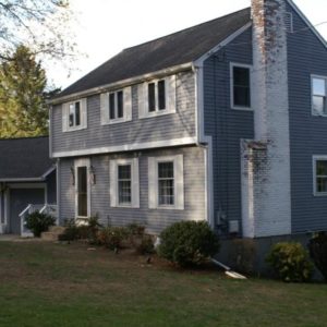

I plan on having a large wrap around porch added to my house and I am looking for suggestions on materials to use for the construction of this porch.
I am located in the Northeast, (45 min. outside of <!—-><!—-> <!—->Boston<!—-> <!—->).  The front of my house is roughly 30 ft and the side is roughly 35 ft.  I plan on putting a roof across the front and wrapping it around the corner, then ending the roof and narrowing the porch down from 10 ft wide to 6 ft. wide with a pergola above the section without a roof.  The porch will meet up with a large deck at the back of my house.  At my Front door I would like to add a vestibule, (small air trap), that will encase the front door and serve as the entry way (not heated).  I have attached some concept drawings of my vision for this project as well as a photo of my house.
I grew up in the Northeast, and have liked the older houses with tongue and groove porch flooring and small vestibules with the storm windows/screens which can be replaced for the seasons.  I had envisioned using tongue and groove mahogany in the areas that were covered by a roof, but have been given some feedback against this based on the fact that wind blown rain/snow can get on this area and cause premature rot and cupping.  I now believe I will use standard mahogany decking, (which will match what I have on the back deck), but inside the vestibule I will use the tongue and groove mahogany.  Should I consider anything else?
I have been looking for some single paned storm windows and screens that I could use for the vestibule, but haven’t been able to find what I am looking for.  I would love to here some suggestions of what I could use for the door and windows in the vestibule.  Double paned windows would seem to be a waste for this area?
Lastly my house has lap siding, with composite shingles for the roofing material.  I envisioned a standing seem metal roof, but I am not sure it would blend in and fit with the style of house I have.  Would the standing seem metal roof be too dressy for the house, or would it add some character.
I am open to any ideas or suggestions people may have about this whole project (not just my questions).  Based on the high level of experience from the members of this forum, all feedback will be greatly appreciated.
Thanks,
Paul
