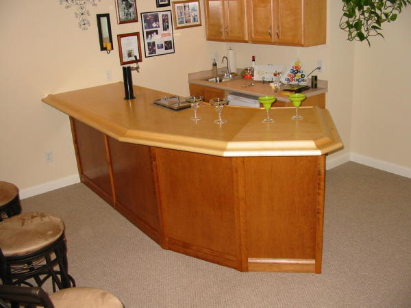

I like it, you have two different woods there, what are they and how are they finished?
JMadson,

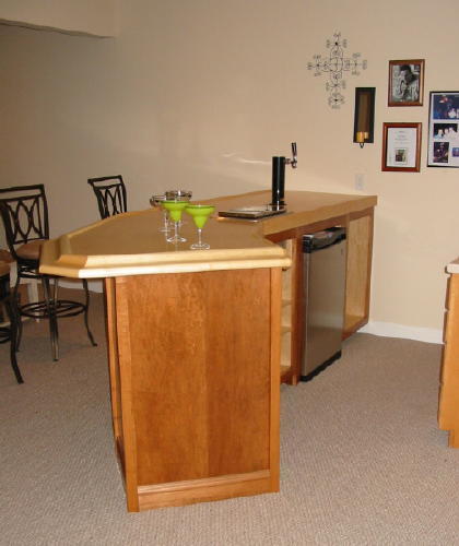

The bar is all Maple, the base is stained and the top is clear. It is finished in catalyzed lacquer, semi-gloss on the base and satin for the top. I built up the finish on the top to give it more durability, we'll see how it holds up. I especially like the kegerator!

Did you do a glue-up on the top or is it ply?
Tom,
The top is Maple ply...it is three layers thick, but only solid on the outer edges, so that the bar edge molding could be supported sufficiently. The cabs and panels were designed in eCabinet and cut on a Thermwood CNC.
