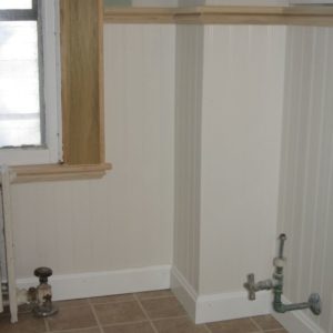

    1. cameraman | Dec 20, 2009 12:40pm | #7
      I have not been able to find the PVC board, did find some nice real plywood 4x8 paneling. Looked nice, knots, nice clean beads, should take paint well. I'll prime it up and feel safer with this product.
      That a real hefty toilet supply you have there!!!

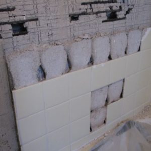

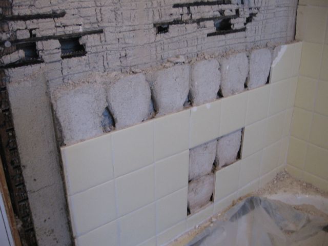

        The toilet supply mimicked the rest of the construction. I had to use a demo hammer on the tile: 1.5" concrete mortar bed on steel mesh, all around the walls and to the ceiling in the tub. Buttonball bed, I think it is called. Took a week to demo just the tile, bed, and lath. Any wonder the shower leaked like crazy?
        1. cameraman | Dec 20, 2009 02:25pm | #9
          Wow, Demo that will make the house lighter!!!
          I had pretty much the same set up on the floor of this second floor bathroom that's getting the beadboard.
          With the plastered wall I was afraid of cracking the walls below!!
          Not a crack!!
