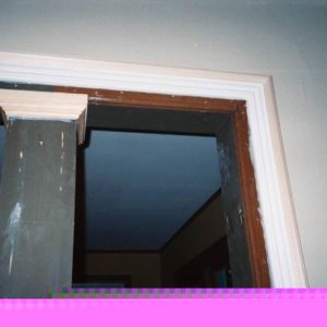

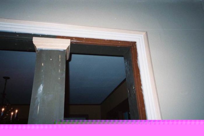

        For paint-grade trim, I much prefer poplar or basswood over mdf. I think MDF has its' place. It is a good choice for crown (out of harms' way), for painted bookcases (faced in poplar), and for 1x4 casing and 1x6 base (routed with a round over, or back banded in poplar).Here is a pic of a victorian reclaimation using a modern mdf base as casing with basswood banding.Cheers
