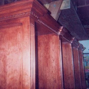

    goldhiller | Aug 01, 2003 04:34pm | #2
    Here's a pic of bookcase crown with a number of "returns". They're the little short pieces you see across the front.
    Don't remember now who posted this pic a while back, but it was handy and so I grabbed it.

    2. Piffin | Aug 02, 2003 02:08am | #6
      goldh
      I'm not sure, but my memory puts that bookcase as GBWoods' work.
      1. gbwood | Aug 02, 2003 03:46am | #10
        good memory, Piffin- thanks!
        greg
        1. Piffin | Aug 02, 2003 04:16am | #11
          Not that good, but outstanding work stands out in my nogin.
        goldhiller | Aug 02, 2003 05:51am | #13
        Well then. That puts you one up on me even if you're not right. At least your memory is telling you something . :-)
        Edit: And now I see you were right. Well, you're two up on me then.
        Been a tough week out there.
        Edited 8/1/2003 10:53:24 PM ET by GOLDHILLER

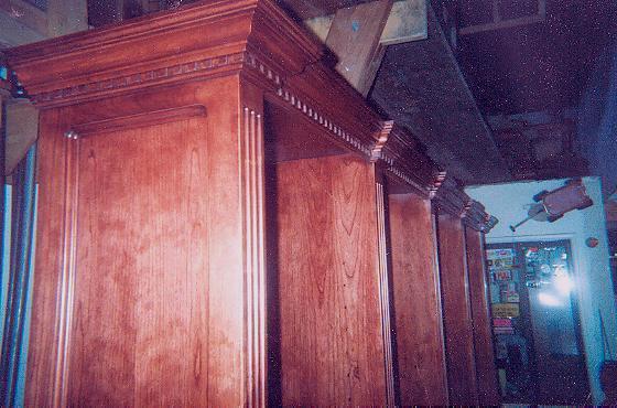

  4. DougU | Aug 02, 2003 03:03am | #7
    Wain
    Just another picture of a return, its exterior but that doesnt matter.
