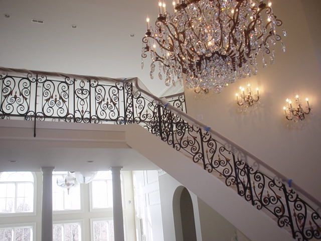

I just finished up a stairway that was started late 2003. I have not been back for 6 months as this house is dragging on.
The railing is wood and currently bubble wrapped. The treads and risers are all stone.
I had to build the carriages extra strong to support all the weight. It does not wiggle in the least.
This was by far the heaviest stairway I have ever moved into a house.

Unbeleivable! Outstanding!Did you do the metal work also? Was the structure steel or wood? How long to fabricate and how long to install? Any special wall blocking required? Arg, so many questions...F
Frankie: Thanks.....I have a very high end iron worker that came to my shop. We worked together getting the logisitics of having his work and my work come together in harmony. It was a challenge to say the least.
This stairs was built in my pre-tornado much smaller shop. I needed the hight ceilings that I have now.
The stringers are 17 inches wide...solid laminates and 3.25 inches thick.
Most of the time was spent in my shop. The onsite work was minimal. I know thats hard to believe...but it was nothing but a giant kit that just had to be reassembled. If you go back in the photo gallery...you can see many pictures of this stairway as it was being built.

Doug: The guy that did the iron work was Dean Rose from Urbana,Il.
He was born 100 years too late. Here is his website. This stairway is on the front page.

Can I venture a guess and say that the home owner is a musician? Or at least loves music????
The railings have a treble clef motif and the landing looks like a "Grand piano"

Jet: They are both surgeons.
