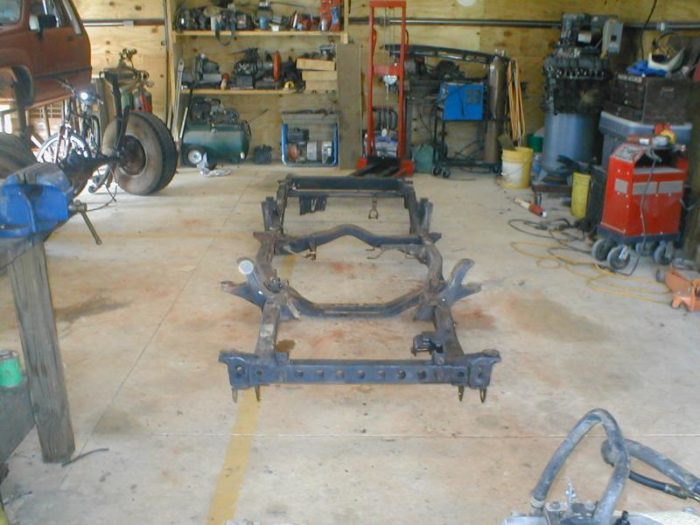

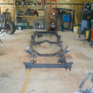

      this is my 24x30, and its not big enough

        1. brownbagg | Nov 07, 2005 07:16am | #10
          I use it mainly for metal fabication. I rebuild 4wd's.
          1. cawfy | Nov 07, 2005 07:36am | #11
            Brownbagg,you have a hoist set up in there for heavy lifting? Is that
            plywood over a slab? Or is it just a regular floor deck no slab at all? thanks, george c.

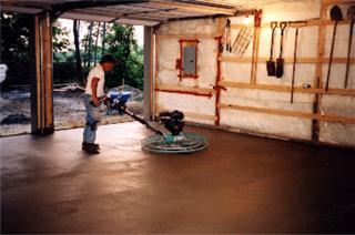

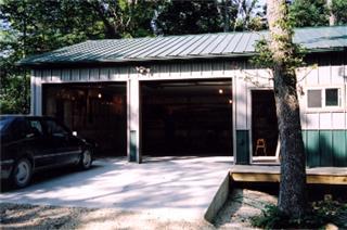

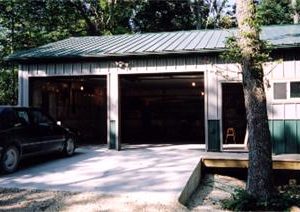

      FWIW...combo shop/garage, Morton Buildings $17K for the shell with doors 3 years ago:
      Another $5K or so for the slab and apron with PEX
      A few more $K for finishing touches
      Edited 11/7/2005 11:53 am ET by johnnyd
      1. cawfy | Nov 09, 2005 04:36am | #18
        Johnny D.,thanks for the reply and the pics.It looks like a good job.Did you have it built or did you do it yourself? What size is the shop/garage combo? thanks,
        george c.
          johnnyd | Nov 09, 2005 04:43pm | #20
          It is a Morton pole building, that was framed up and dried-in in about 2 days.  I wired it,  put in the windows, insulation, and partitioned and finished a guest bed/bath on one side.  It's 30X40.
