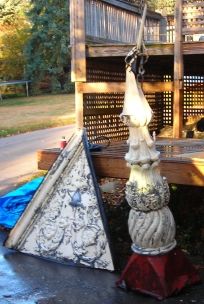

My next project (got started this afternoon) is restoring these two pieces off of a church. All the parts are there for the gable piece. It got dropped and bent up the crown mould and the bottom is badly rusted. The spire also got dropped and damaged the top, but the leaf work around the center is mostly missing and the base is rusted.

You have a bigger picture ?
But don't put it in the post... Just attach it.

Thanks.Kinda hard to see anything in that small pic.=0)

More pictures!
You must be psychic - I was just changing the batteries in my camera. Just a minute.http://grantlogan.net/

Here ya go:
Spire before:
and after:
Lower tier before:
And after - I made the leaf parts from 3lb lead. Not perfect, but they ought to look OK from 80' down:
Here's the whole thing complete:
They were looking at about $25K for a replacement piece. I brought this repair in for a little less than $2K.
Here's the gable piece before:
Had to remake the crown mould, strip the paint, and reattach some of the pieces:

The lead idea was a good one. What did you use for a (female) mold?
I love to see that quality of work.
Don K.
I carved out a negative in a block of wood. To fix the spire, I jammed a piece of pvc pipe up the inside of the sharp end and kept adding unions and size increasers to match the flare. I then riveted the mangled pieces to the pvc to get them back close to their original form.http://grantlogan.net/
