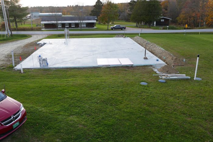

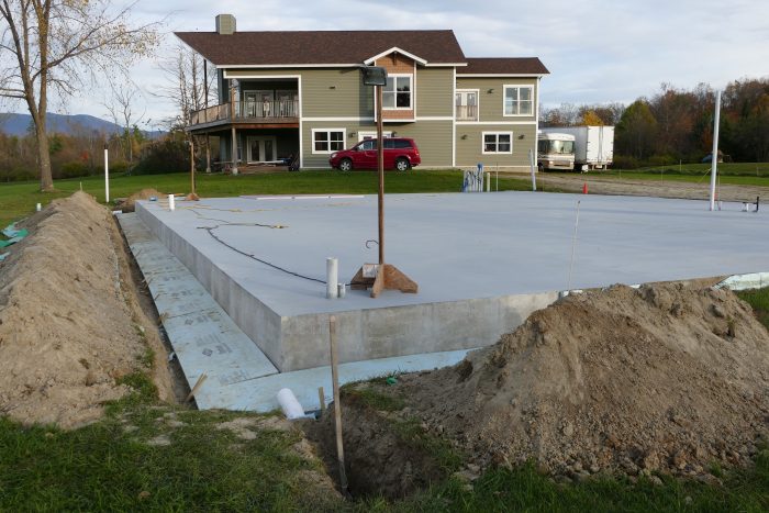

I am just about to start building a new workshop … about 3500 sq ft.  Pad is in, waiting for the snow to melt to start building.

    I am hoping the shop will be relatively dry .... I put 2" of foam under the pad and also a vapor barrier (poly).

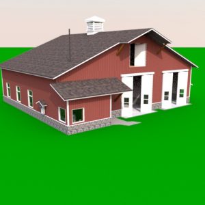

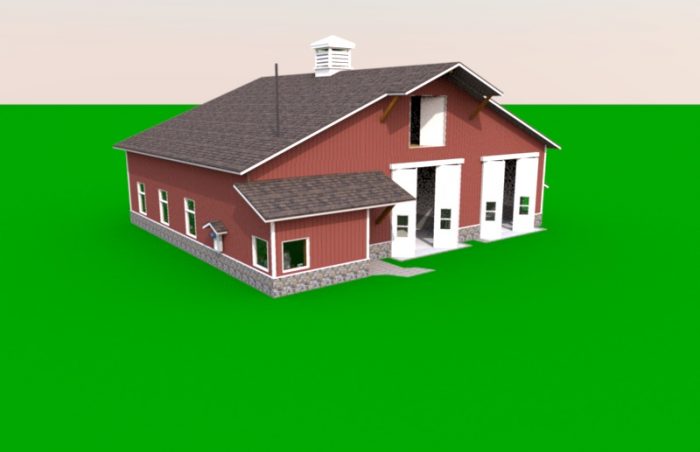

    Are you going to build in the second floor access as shown in your original post?
