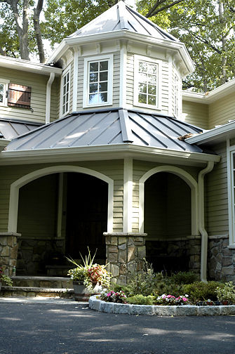

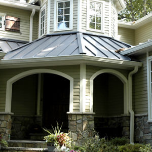

      Sphere | Aug 26, 2006 10:14pm | #14

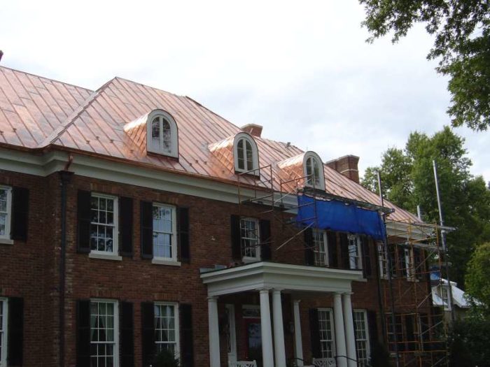

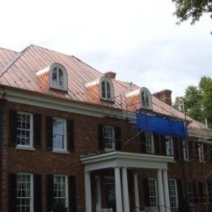

      Real nice work on a real nice dwelling.
      I have objections to the oversized hip/ridge coverings tho'.
      We do tons of copper in a half a year, and really, I am sold on it.
      " If ya plan to face tomorrow, do it soon"

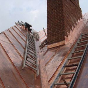

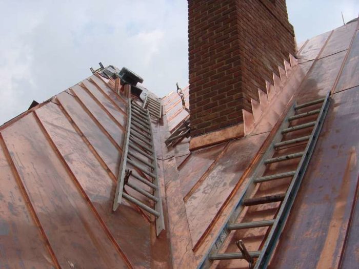

      1. davidmeiland | Aug 26, 2006 10:42pm | #15
        That's freaking HOT!
        On those dormers, am I seeing ribs running perpendicular to the main roof plane?
          Sphere | Aug 26, 2006 10:51pm | #16
          No..they are 12x12 squares laid on the bias. Nailed/screwed up on the underlap and popriveted to the lower courses. Want more pics?
          BTW it was last July, and yup, it was HOT..150º and higher..see the stains? That is bodily fluids.

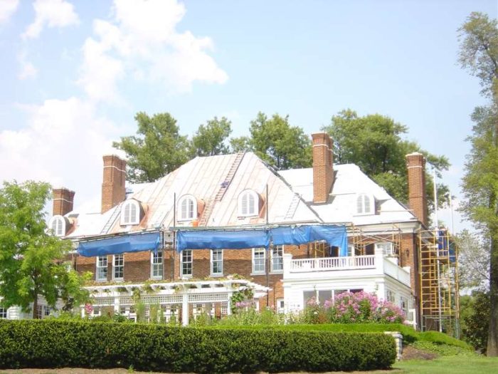

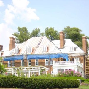

            I only have a few yrs left in this work, so I want it to be memorable...and this ( pictured) job was one that wil stay with me for a LONG time. I love it.
            I have only 2 yrs exp. with this sort of stuff..Grant acquired me for his woodwork..then he cut me loose on this new found trade..glad he did.

          4. davidmeiland | Aug 27, 2006 12:14am | #20
            Man, that looks dangerous. You guys need parachutes. Seriously, everyone harnessed up or is that too much of a nerdy PITA?
            Sphere | Aug 27, 2006 12:43am | #21
            Nah..never a rope. See them vise grips holdin the chicken ladder?  Thats us on that..Dale is 230lbs w/out tools, I am 175 in the same state.
            I respect gravity.
