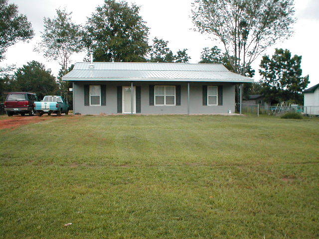

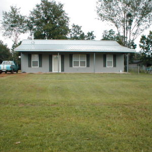

          I was going to stay out of this con- vo because I really did not have much to offer.  I installed a metal roof on my house, it is a light grey painted galvanize with 40 year warrenty. It screwed every two feet. We have had 21 inches of rain since 1st of may, no leaks. It was cheap in price $1100 and I installed whole roof by myself in a weekend. It is metal, tarpaper, plywood no slacks But its also a simple gabel I would hate to do a hip or the fancy pitches. My powerbill has been very low due to light color. But ask me after the first hurricane how its hold up.
          Tip: tennis shoes, chaulk lines and metal roofs do not mix
