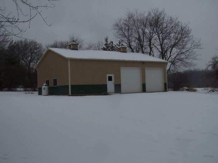

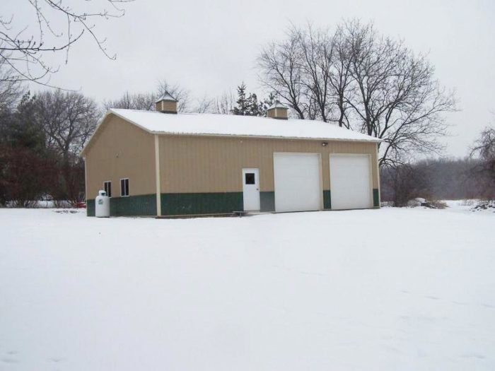

    Here's a picture of my shop, which I built 6 years ago.  All metal exterior, 45'L X 36' W.  It's full span with trusses, no interior support posts.  I could have gone alot wider, too.  You will have no problem.
    I built it myself in 2 weeks, had 1 helper with the siding.  I set the trusses with a crane.  Piece of cake.
    1. BilljustBill | Jan 28, 2009 12:25am | #22
      Jeff,
      I like those cupolas!!  Were they hard to get up there?
      Bill
      1. JeffHeath | Jan 28, 2009 04:26am | #26
        They were actually a pain in the neck.  I built them on the ground, and put a pallet on forks on my bobcat.  I lifted it to its capacity, 10', and had a rope tied around it.  I got up on the roof, and hauled it up with the rope.  It wasn't pretty, but it was effective.
    2. pebble | Jan 28, 2009 12:36am | #23
      I couldn't see the shop very well so I increased the brightness and lowered the contrast a bit. Snow can be tough to take a picture of.
      Edited 1/27/2009 4:36 pm by Pebble
      1. JeffHeath | Jan 28, 2009 04:14am | #25
        Sorry about that....I posted the picture in the file that was before I photo-edited it for brightness.  Thanks for reposting.
