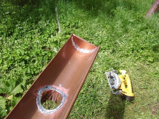

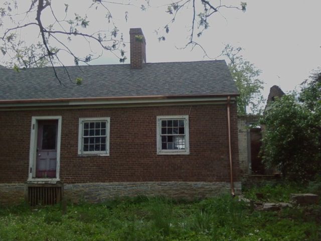

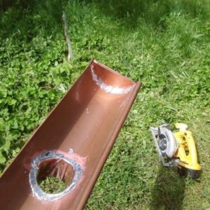

Just a quickie incase anyone likes copper gutter.
This place was a real treat, a true pigs ear..abandoned and getting rebuilt..kinda cool.  I just hung a straight run, small job.

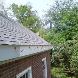

Snapped a 35′ line and sloped it, and hung the hangers.
Measure for the drop location and chop it out, solder it in and add an end cap.
Throw it all up, add a downspout, solder the joint, add the clips to hold it in and thats it.
Nice peaceful day,in the country.
