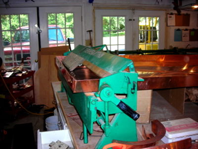

Here’s the 4th side of the base being bent in the box break:

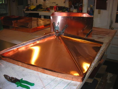

Then I had to make up three 22' long pediment roofs. I got two finished and I'm finishing the 3rd this morning. I ran out of copper.
Here's the standing seam blanks getting formed to fit the roof:
Continuing:
And here's half of one of the roofs, ready to install:

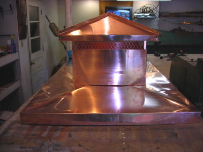

And then I made five chimney caps to be installed today. Got done about 1:30am.
Bending the small sides on the box brake:
A finished corner - it's all folded tight - no rivets, no solder:
All the tops completed and it's still ight out:
Finished assembling the first one just as it got dark:
1:30am - done - time for supper:
