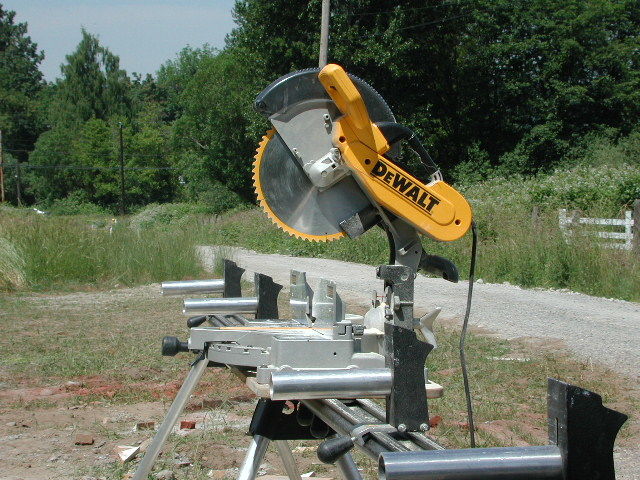

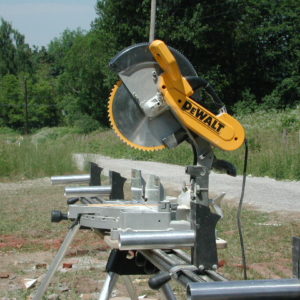

          ProDek | Oct 08, 2003 06:01pm | #11
          I'm amazed that the table that the chop saw sets on has not delaminated in all the years is has been used in the rain. I don't know what kind of material it is made of but it looks like MDF. I thought it would swell up and come apart by now but it still looks good as new.
          Here is a shot of my stand and  side rollers I had my "machinest" son make for me, the plastic ones broke. I filed for a patent and then Dewalt went and changed it's configuration.
          You probably have the new Dewalt stand w/o the table. How do you like that? "Rather be a hammer than a nail"
          Bob
          1. Turtleneck | Oct 09, 2003 04:00am | #14
            Thats a pretty slick rig. I haven't gone digital so you can only show me yours. Ha!  We use waterproof MDF for basement window box-outs, maybe thats what you've got, I never left it out in the rain to see what would happen.
            I can't use stops along my rails because I "bend" miters to get a tighter fit. I was using a homemade plywood stand for years untill I picked up a portable stand for service work. I liked it so much I tossed the plywood one. The thing is $40 cheaper today than when I bought it a year ago for $150 CDN.
            Probably a little light for your work.
            Heres the link  http://www.wolfcraft.com/product_detail.cfm?id=117  Turtleneck
